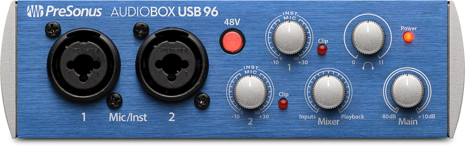

Does anyone have hands on experience of this AI please?
The unit seems very good value for 'name' with 2 in, 2 out and MIDI with the very capable Studio One software. The fly in the ointment however seems to be the mic pre's gain specc' at just 35dB. That seems very low and really not fit for the almost inevitable coupling of a budget AI and a dynamic microphone?
PreSonus have a reputation for excellent mic preamps in the rest of their range and I have never read of a 'gain shy' product. Could this be a typo?
PreSonus 96 USB
PreSonus 96 USB

Re: PreSonus 96 USB
Pretty sure it's a typo.
The front panel gain knobs are marked as INST -10 to +30 and MIC 0 to +60
Also, page 3 of the manual states:
https://www-media-presonus.netdna-ssl.com/downloads/products/pdf/AudioBoxUSB96_OwnersManual_EN_25052017.pdf
Presonus wrote:Input Gain/Trim Control.
These knobs provide the following gain structure:
• Microphone: 60 dB of variable gain (0 to +60 dB)
• Instrument: 40 dB of variable gain (-10 dB to +30 dB)

Re: PreSonus 96 USB
Ah! Thanks Hugh. I went straight to "specifications" so, must be a typo.
