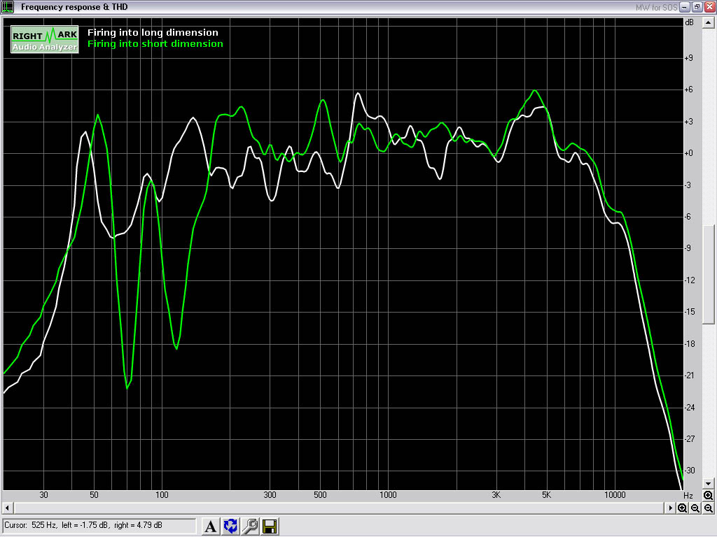

Indeed firing down the long axis is normally preferable (although as James says this may not always be the case, depending on the individual room), because you generally get less 'nasties' as a result of the rear wall being further away.
This image of mine has been trotted out a number of times over the years (and even been used in a book), but it illustrates how in my own small studio before any acoustic treatment had been fitted that firing down the long dimension gives you a head start achieving a flatter response at the low end compared with exactly the same measurement firing down the short dimension.
Last edited by Martin Walker on Tue Oct 08, 2019 10:59 am, edited 1 time in total.

Yes, swings and roundabouts, but on balance firing down the long axis does seem to give better results more consistently... in my experience.

Yeah it's a squar-ish room?
In the end of the day is about how fast reflections bounce back to the listening position, how much energy they have kept upon bouncing and how much they dissipate during travel.
Having them running the length of the room helps with the more directional frequencies. But if the issues are related to low end, it makes little or no difference, and can even worse things off... both because the difference in the length of the two sides of a normal rectangular room will be relatively small with respect to the wavelength, and because long low-freq waves will immediately reflect back from the sides (which in a long-fire configuration are nearer...), not just the back wall.. so you will have two near (hi-energy) reflections instead of one, which can make things even worse.
If I had to choose, I'd try both and listen. But there's really no alternative to a treated room, especially for bass. Maybe a super-big one
