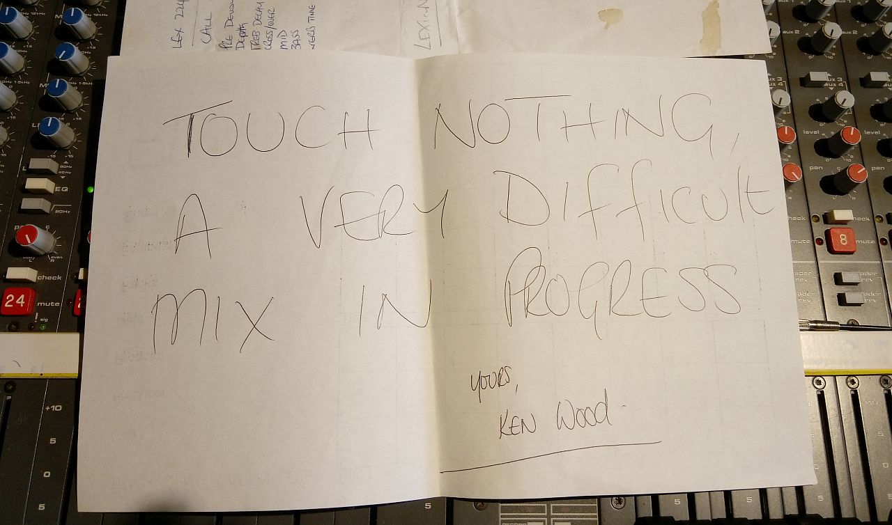

I do it all the time. I like to be able to take a break and come back to a mix. I'll also often send off a mix for approval and then work on other projects. The client will often come back with a list of changes so I'll make the changes, send it off and get on with other stuff again. I'll often have 2 or 3 mix projects on the go at once.
This thread reminded me that I found this from the 1980's in a tape box the other day.

James Perrett wrote: I found this from the 1980's in a tape box the other day.
Hey, a Kenwood Mixer
Nice pic!

Eddy Deegan wrote:James Perrett wrote: I found this from the 1980's in a tape box the other day.
