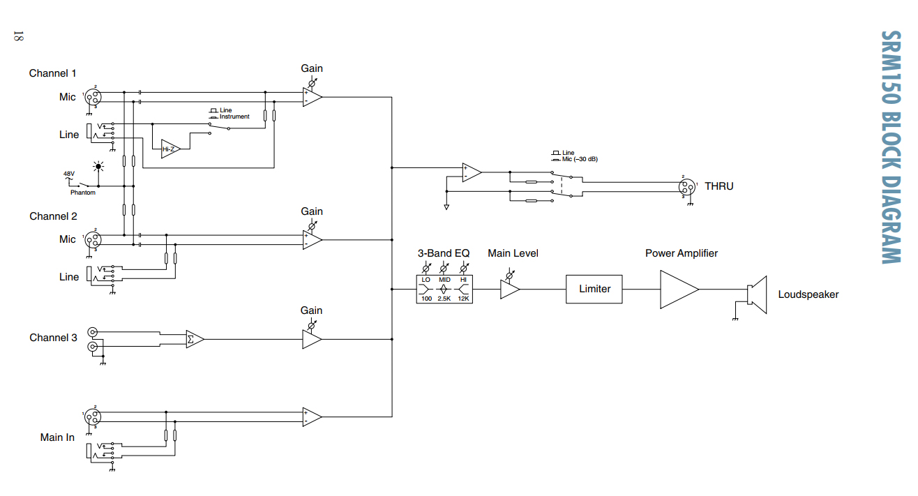

Surely there would be a feedback loop if using Channel 1 to send to a PA via Thru, then receiving a monitor feed via Main 1? The block diagram shows Main 1 is also fed to Thru

You can safely use the mic in/thru to feed the mic signal to the monitor in 'more me' mode and a desk fed mix as on the TC VoiceSolo at least, the line in is not routed to the thru output. For a feedback loop to exist, the desk mix would have to be routed to the thru output.
I suspect that diagram in the Mackie manual may be wrong (I'll download it and have a look later maybe).
edit :- I think you are right, the manual says "11. THRU Connector
This is a male XLR connector that produces the main signal just prior to the EQ [7] controls and the MAIN LEVEL [6] control. The signal at the THRU connector includes the input signals connected to channels 1-3 [1/2] and the MAIN IN [13] signal.
Use this connector to patch the signal from the SRM150 to another SRM150 or other active loudspeaker (like an SRM350 or SRM450), or to a mixer."
That means the SRM150, unlike the VoiceSolo, can't be used as a 'more me' monitor in conjunction with a desk mix and can only be used for a single vocal......

Paul99f wrote:Surely there would be a feedback loop if using Channel 1 to send to a PA via Thru, then receiving a monitor feed via Main 1?
Yes there would... so you have to wire it into the rest of the system intelligently!
The idea of the Thru output is to pass on a line-level mix of whatever sources you have connected to the SRM150's inputs to feed some other device.
The handbook illustrates this with an example of connecting the user's vocal mic and instrument to the SRM's front panel inputs, so the unit can provide local artist monitoring, and then use the Thru output to feed a PA speaker for the audience -- making a very simple and self-contained performance system with local control.
An alternative configuration might involve feeding the SRM150's rear-panel Main Input from a desk's Aux send to provide a local artist monitor, and use the Thru output to feed a second floor monitor either for another performer or for the same one but in a different position on the stage....
When working with an FOH mixing console, you wouldn't normal route the vocal mic/instrument directly through the SRM, firstly because this would remove control of the vocal/instrument balance from the FOH mixer, but also because of the potential howlround issue you mention. In this situation, the sources would normally be connected straight into the mixing desk and the SRM would then receive an Aux send for monitoring purposes so everything is controlled from the desk, with no risk of howlrounds!

Sam Spoons wrote:You can safely use the mic in/thru to feed the mic signal to the monitor in 'more me' mode and a desk fed mix as on the TC VoiceSolo at least, the line in is not routed to the thru output.
It is, apparently, in the Mackie (diag from manual below). There are both pros and cons to routing the external line input to the Thru output, so neither option is right or wrong; they just offer different benefits and limitations.
Not at all. It can certainly used as a 'more me' monitor. But you would need to split the mic and/or instrument inputs to feed both the SRM and FOH mixer independently, rather than use the Thru output to feed (a mixed signal to) the mixer. You would then provide an 'everyone else' monitor feed to the SRM via the main input.
But personally, I'd much rather work this way, anyway, even with the VoiceSolo, to ensure artists tweaking on the personal monitor can't mess up the FOH mix!

Hugh Robjohns wrote:Sam Spoons wrote:You can safely use the mic in/thru to feed the mic signal to the monitor in 'more me' mode and a desk fed mix as on the TC VoiceSolo at least, the line in is not routed to the thru output.
It is, apparently, in the Mackie (diag from manual below). There are both pros and cons to routing the external line input to the Thru output, so neither option is right or wrong; they just offer different benefits and limitations.That means the SRM150, unlike the VoiceSolo, can't be used as a 'more me' monitor in conjunction with a desk mix and can only be used for a single vocal......
Me too as sound engineer but the thru on VoiceSolo does send a clean mic feed to the desk You are right, of course, with the SRM a mic split would solve the problem (which is what, effectively, the VoiceSolo does internally) should you want to give the talent some control (which I do when said talent is me
