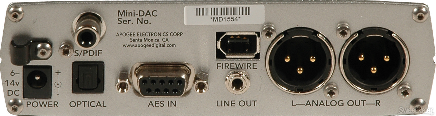

Image of rear of miniDAC
http://www.sweetwater.com/images/closeup/xl/1600-MiniDacFW_rear.jpg
Does this sound feasible? Anyone know for sure if it would work before I splash out my hard earned?

I used to have the same rig. The best thing would be to get an 8 channel preamp with adat out such as the Digimax or the Octopre. That would prevent any additional strain on the firewire buss. In answer to your question though, yes it should work. Good luck.
