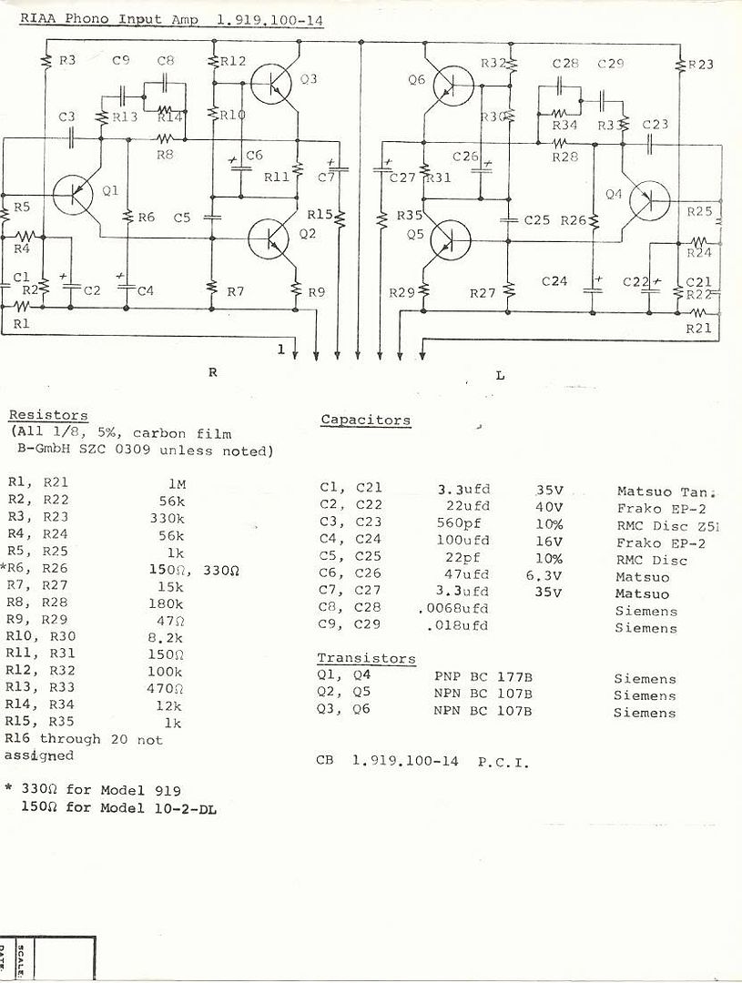

Hugh (Or any one else for that matter) can you recommend a good step up transformer for the Denon DL-110 MC cart to go into my MM stage?
I was looking at Sowter transformers but the choice is a bit confusing for me
Here is the schematic for my MM input card in my mixer
http://i197.photobucket.com/albums/aa272/vinyl_junkie_2007/Bozak_CMA-10-2DL_Schematic_RIAA_Phono_Input_Amp.jpg
Output impedance on the Denon apparently is 160 Ohms, reported output is 1.6mv but apparently it's more 2.2mv
Being a HOMC I read it's meant to be ideally used on MM stages (47k load) whether this is bull I don't know
