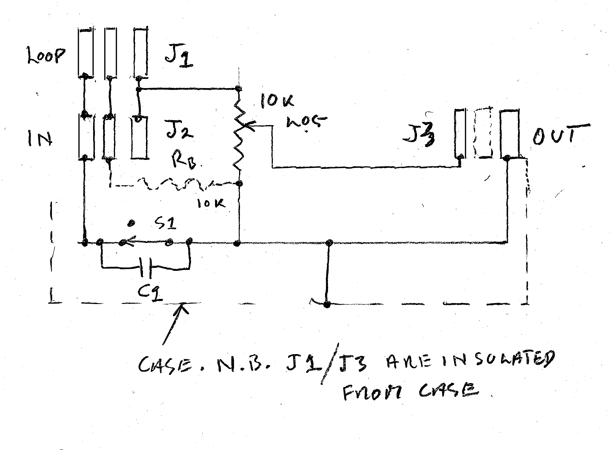

Re: LR Baggs Para DI - lack of earth lift problem
If I could add an attachement I could give you a drawing and a schematic but sadly not possible on THIS forum AFAIK!
You can Email me via pm.
#They did not listen, they are not listening still...Perhaps they never will?#
Re: LR Baggs Para DI - lack of earth lift problem - SOLVED
Well folks, I would like to thank Dave for his 'Earth Lift Box' schematic. It works a treat.
I did find it only worked when used before the LR Baggs DI rather than before the amp as suggested, but that's where the earth lift would normally be anyway I suppose.
Nice one Dave
Nice one Dave

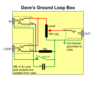

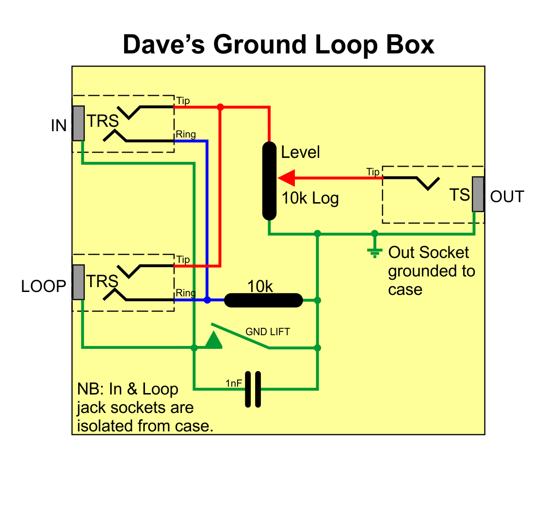

Here is a schematic for Dave's ground lifting box with adjustable output level:
And here's the original:
I'd use plastic jack TRS sockets for 'in' and 'loop'. Probably easiest to use a guitar all-metal type TS jack socket for the 'out', as it saves having to make a separate ground connection to the case (which should be metal, not plastic, for shielding purposes).
Wonks wrote:I'd use plastic jack TRS sockets for 'in' and 'loop'. Probably easiest to use a guitar all-metal type TS jack socket for the 'out', as it saves having to make a separate ground connection to the case (which should be metal, not plastic, for shielding purposes).
Wonks, I loathe and detest those "bent tin, horrible imerican" jacks! Because of that I never consider telling people to use anything other than plastic!
Well poshed up Hugh, ta!
Well, considering that's what's in almost all electric guitars (either that or the much more failure prone barrel jack socket), and that a good Switchcraft jack socket will happily last 30 years plus, I don't see what you can really have against them.
