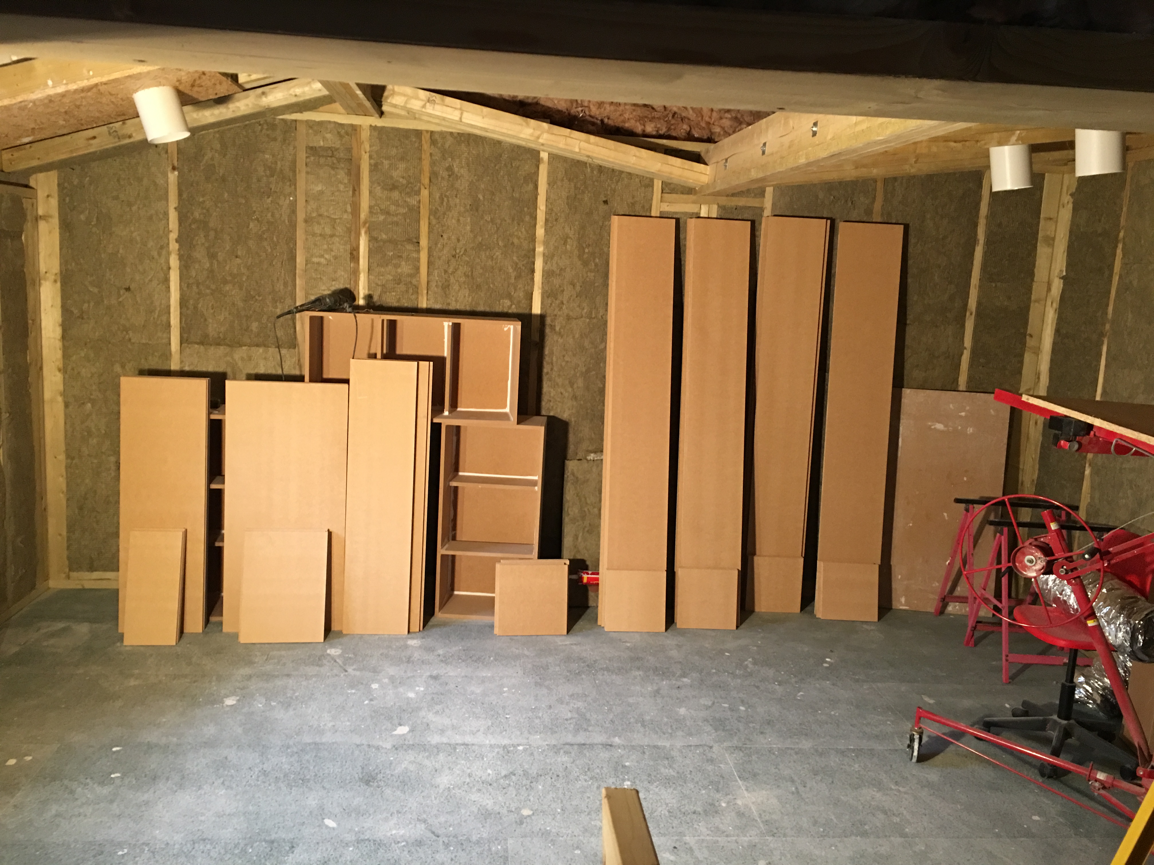

Building cupboards into the wall of the tracking room. I need to house the consumer unit (fuse board) and some other electrical equipment like lighting control etc and also some audio visual and network equipment. It’s not ideal being in the tracking room so I’ll have to make the cupboard silent. More importantly the cupboard back, sides and top become part of the wall so must have at least the same mass. Therefore they will be covered in at least three layers of plasterboard. This makes good use of the potential wasted space in the large void between my rooms.
Cassette for live room wall Being made.
Cassette in place in the live room wall. Ready to be lined with plasterboard to increase mass.
Back of the cassette viewed from the control room. Cantilevered from the tracking room wall it does not touch anything. It has a layer of plasterboard outside. There’s still around 300mm of air gap between the back of the cupboard and control room studs. Plenty for my isolation needs.

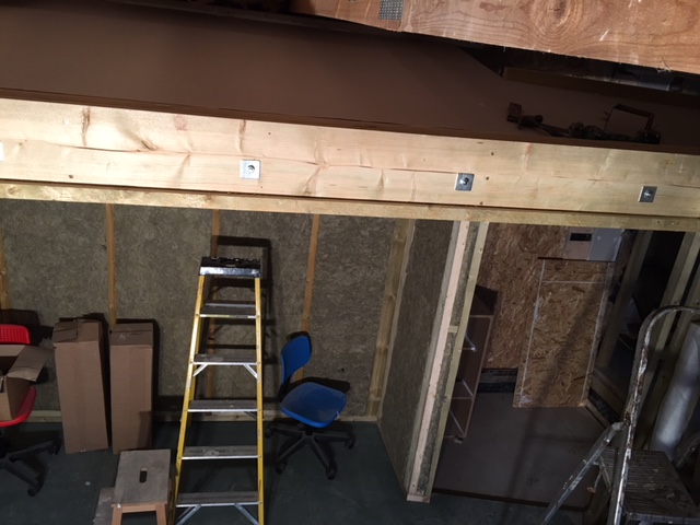

Following are images of the rear 3rd of the control room. The deck is on top of the joists made up of OSB and layers of 12.5mm plasterboard. The exhaust attenuators will sit on top of this deck. The underside will be cloth faced and form part of the acoustic treatment.
I also Joined the inlet attenuators together and boarded them to maximise the attenuated air path. This is now ready for connection to the acoustic flex duct.

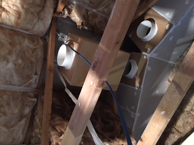

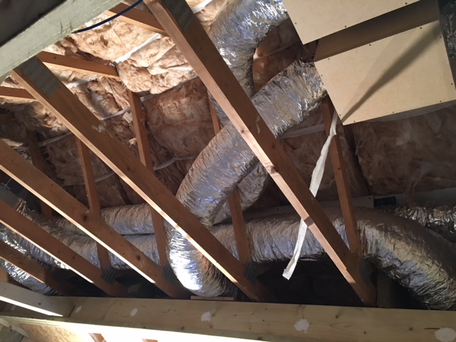

Air conditioning compressors in place, isolators wired in and refrigerant lines run between units.
Fan coils in place. I suspended these from brackets attached to the outer shell trusses with neoprene washers to limit any vibration, although these fan coils are rated as quiet anyway.
Meanwhile I am getting on with building the final break out attenuators for the live room which are Rockwool lined boxes 2.1m long with offset inlet and outlet. They will be close coupled to the ceiling and covered with plasterboard all round to the same mass as the ceiling and lined with 50mm Rockwool.
Finally I made a start on boxes for the fresh air fans to cut down on noise. Originally I was going to mount the fans externally but having made a prototype box I am happy I can silence them, so they will go inside. Similarly they will be suspended from the shell and I will make a post in future on the detail.

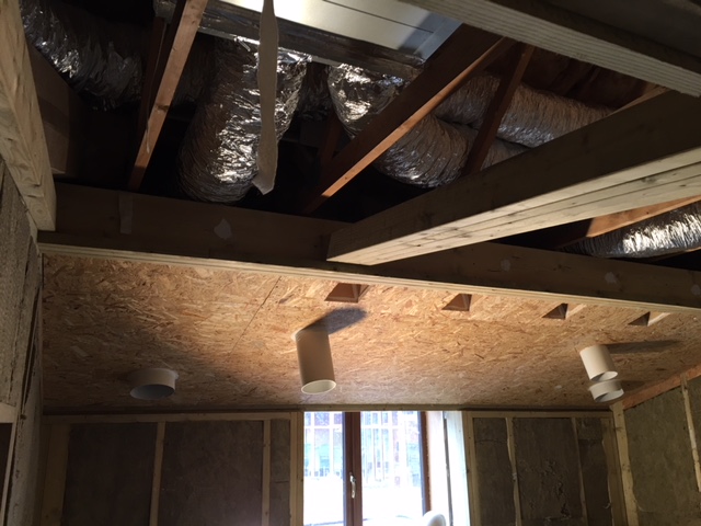

Some updates from the past few weeks.
Refrigerant lines and fan coils in place through the loft space.
Connection and commissioning
That's the air-conditioning complete.

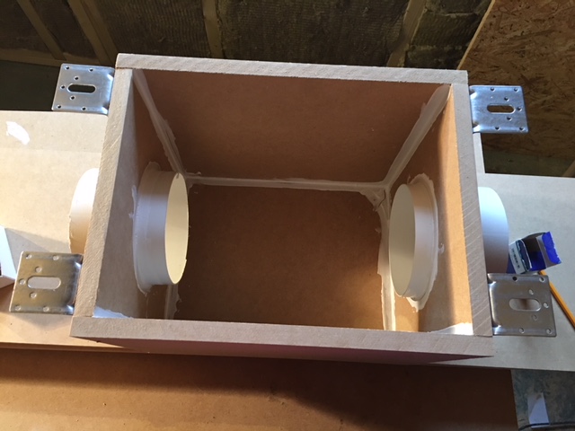

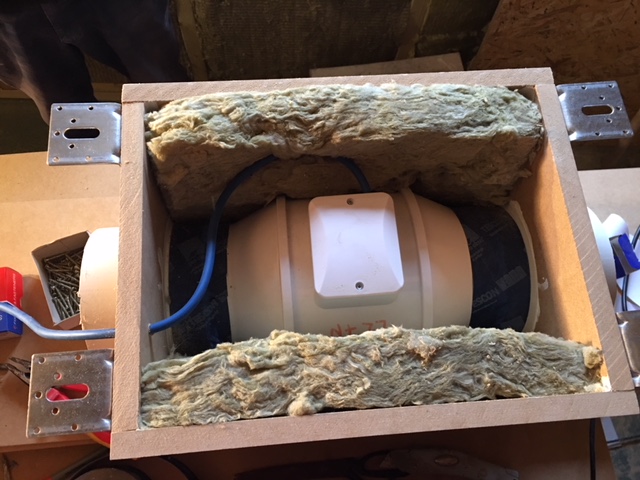

FreshAir Fans
I made a box from MDF
I placed the fan in-between the inlet and outlet and used a fabric tape to prevent a hard connection and then lined the box with Rockwool.
The boxes are suspended using neoprene washers so there is no chance of vibration.
The connections to the attenuators are made with acoustic flex duct.
The fans were very quiet although I could hear air movement noise at the fan outlet connection so I covered the duct with more rock wool which has done the trick.

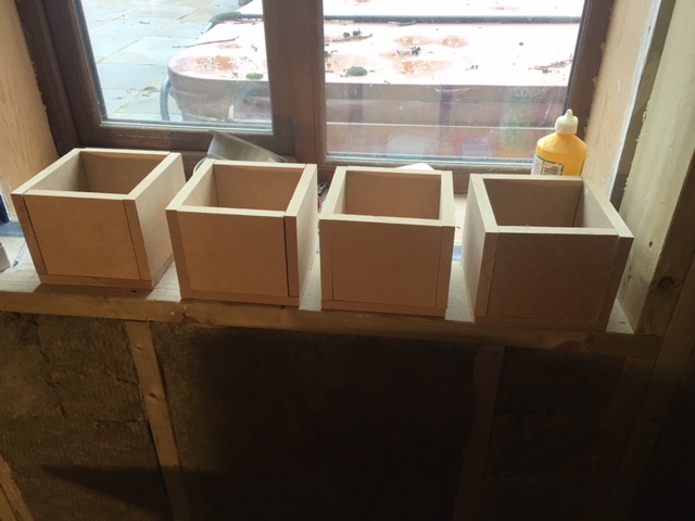

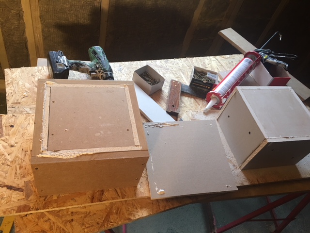

I wanted to put four spot lights in the ceiling. I made 4 boxes from 18mm MDF
I then covered them in MDF and plasterboard layers to match the mass of the ceiling. They end up quite big and heavy.
Excuse the pipes, I'll trim them flush with the ceiling when the final layer goes on.
