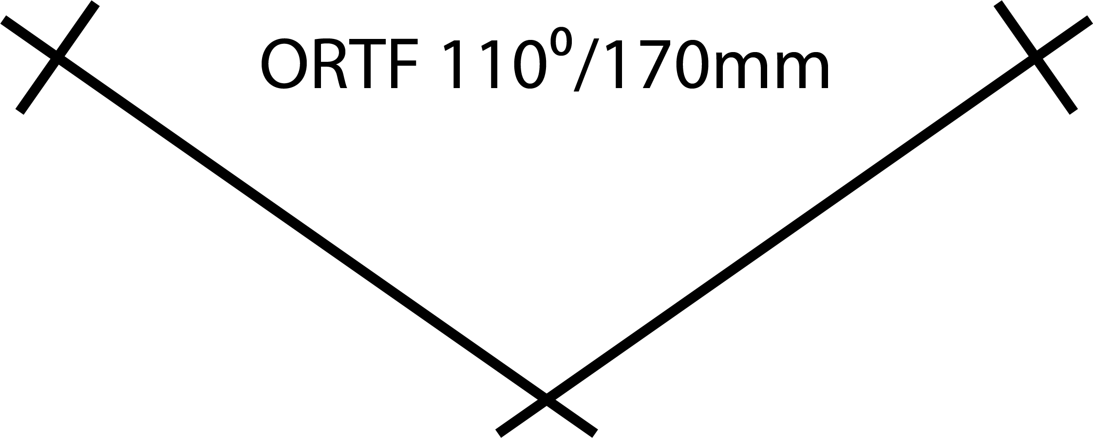

Isn't 217 the exact distance for ORTF?
The mic capsule spacing for ORTF is 170mm, but as the mics have to be angled outwards at 110 degrees their mounting clips on the stereo bar will be a lot closer together.

As has been said, ORTF is two cardioids at 110˚ and 17cm spacing.
To get the height of one over the other that you will need a riser (as Hugh shows on the XY picture above), the easy (and cheap) way is to get a couple of thread adaptors: 5/8" to 3/8" and the reverse - screw one inside the other and you have a riser with 3/8" threads.

For an ORTF array, that SRA is 96 degrees (/-48 degrees from the centre). So as you move the mic away from the choir the perceived image width of the choir narrows, and there will be more ambience at the outer edges. You'd need to space omnis about 70cm apart for the same SRA, although there's then a risk of a very unstable centre image (or even a perceived 'hole in the middle'.

Read that the distance of theics to the source shouldnt be to small w hen u wint ortf. Could anyone give me a guideline? Choir will be 25 people and sort of half circle. I also understand nos is for greater distance betweensource and mic?
Does it matter in ortf to have the m ics in a sort of xy setup or next to ach otter pointing out ?
Btw bought a 20cm stereo bar. For now should be enough. If i succed and want to do bigger ensembles i might consider a bigger bar for spaced omnis
- Guitarking
Regular - Posts: 299 Joined: Sat Jan 09, 2010 12:00 am
Re: Recording classical choir: what technique and what mic stand?
Guitarking wrote:Read that the distance of the mics to the source shouldnt be too small when using ortf. Could anyone give me a guideline?
The guideline is that the SRA for an ORTF array is about 96 degrees, so it needs to be far enough away that the choir fits into that chord angle as measured from the mic. As previously described...
The SRA for the NOS array is narrower, at about 80 degrees, so yes, it would need to be further away for the same choir stereo image width.
It's a bit like camera lenses. If you switch to a longer lens with a narrower field of view, you have to move further away to keep everything in the frame (and vice versa). And just like camera lenses, changing the shooting distance changes the perspective... The acoustic perspective, meaning how reverberant (or dry) the recording is.
Coincident (XY) cardioids are a bit like a fish-eye lens, coincident hyper-cardioids and ORTF are more like a 100mm lens, and NOS leans more towards a 135mm lens... (I've made those numbers up, and the actual viewing angles for camera lenses are much narrower, but hopefully you get the idea...)
Does it matter in ortf to have the mics in a sort of xy setup or next to each other pointing out ?
All that matters is that the diaphragms are spaced 17cm apart, and the mics are each pointing away from the centre line by 55 degrees. How you get them there is down to you, and will depend to some extent on he physical length of the mics and your mounting mechanics.

Ah thank you Hugh, I think I'm beginning to understand.
So 2 cardiods in ORTF make up '1' big cardiod so to speak. Which has a certain amount of ' capturing' degrees?
WIth this site you can see the angle you need to e.g. capture the extremes of the choir into the extremes/borders of the capturing angle of say cardiod etc...??
But: in real life: how does one determine the angle of the extremities of the choir? Is there some formula to say calculate the distance the array has to be from the front of the choir if one knows how wide the choir is?? Sorry, my maths are failing me now...

It's usually done the other way around, because the distance of the mic array from the choir is generally more important since that largely determines the captured perspective and thus the overall character of the recording.
If the room's critical distance value is known then the optimum distance for the mic array can be calculated... But most people just judge it by ear and experience.
Once the mic position is determined you can assess the required SRA for the sound source layout, and from that determine the appropriate stereo array format to provide that SRA.
This is an iterative process as the chosen stereo array might affect the perspective, and so the distance, polar patterns, spacings and mutual angles may need to be tweaked until you get the precise sound characteristics you require.

Guitarking wrote:If I look at the SRA site (or the Neumann) app, it appears to me to get the 96 angle the mics needed to be that far away that the mics pointed a bit outwards of the choir (the RSA angle is a bit inside the mics).
Yes. The mutual angle of the mics is 110 degrees but the SRA is only 96 degrees, so the mics should be pointing slightly outside the choir edges...
But with the formula...the mics pointed a bit inwards.
Oops!
So I expected the stereofield to be very wide
Me too.
But... to me the stereo width doesn't seem to be widest on my speakers.
We need an example to hear...
