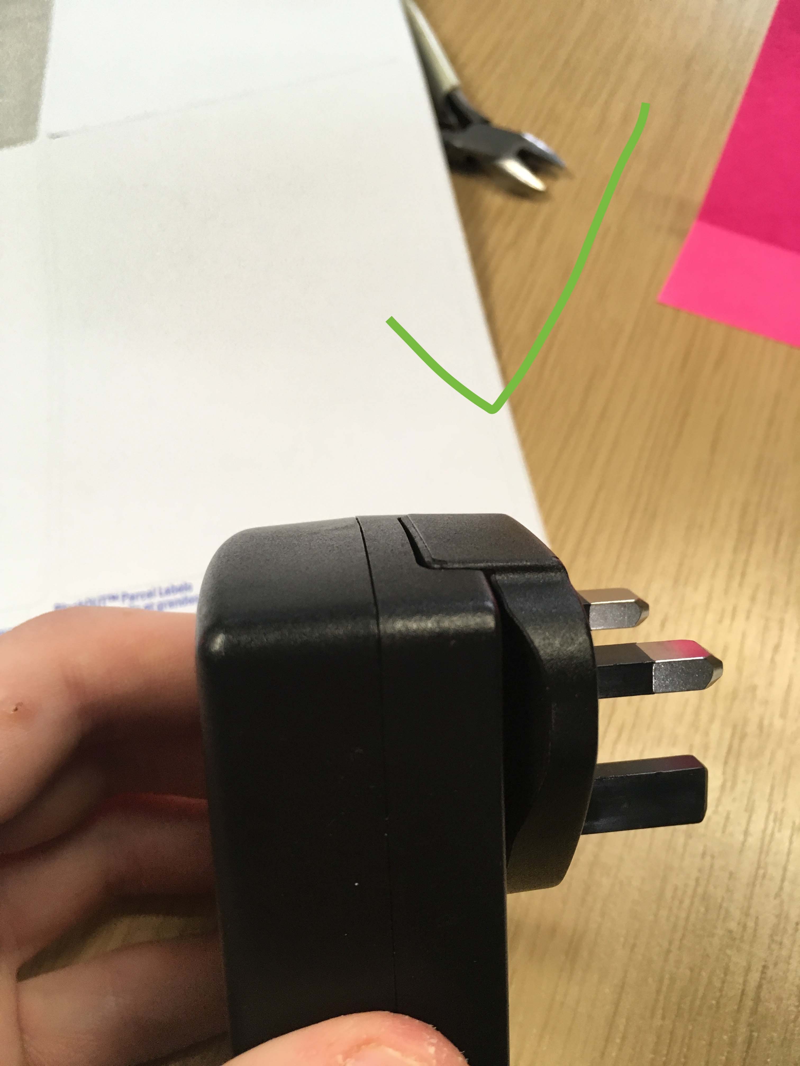

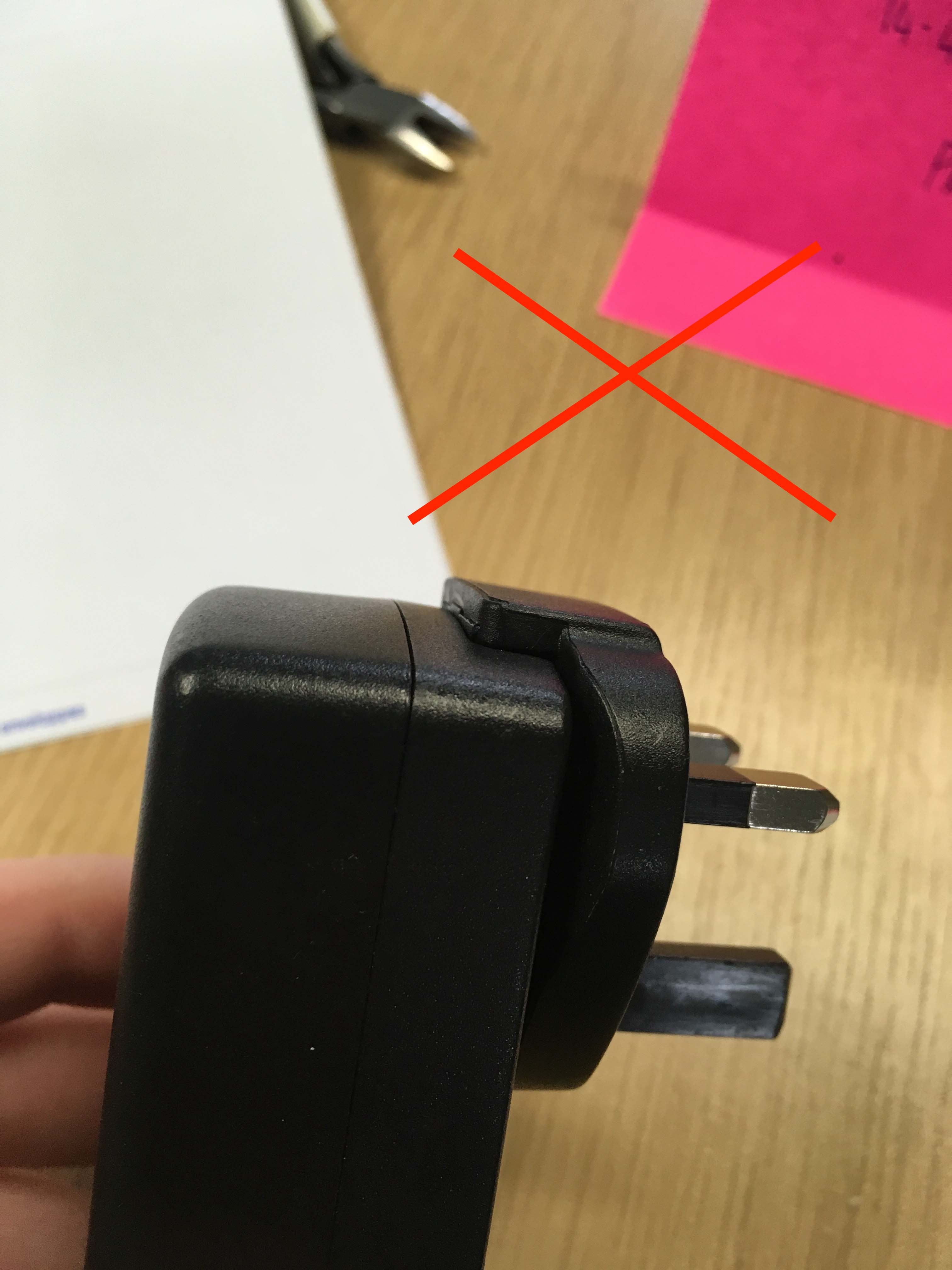

I've mentioned this thread to Dan at Audient. He may be along himself but in the meantime, he has suggested pretty much the same things I have:
Dan wrote:Double-check that the regional pins for the power supply are fully pushed into place. They should click onto place and sit flush with the base of the supply as seen below:
These can be a little stiff upon first use so you may really need to give these a push to get them to sit into place. The unit will still work as the rest of the iD14 will run off the 5V USB bus voltage but the phantom power does require the PSU to be connected up.
If the plug is correctly assembled you can test that the power supply is actually working by unplugging the USB but leaving the PSU in. If the PSU is working the iD14 will remain powered on. If the iD14 doesn't stay on then this does look like a fault with the supply so I'd recommend the user gets in touch with us so we can get a new supply sent out.
The pics show the connecting plate for the UK mains socket -- I don't think we've established where you are geographically -- but the other country-specific mains plates all fit the same way.

I double checked the plug, made sure it was correctly installed.
Okay. It's a simple error to make but easy to check. So that's good.
