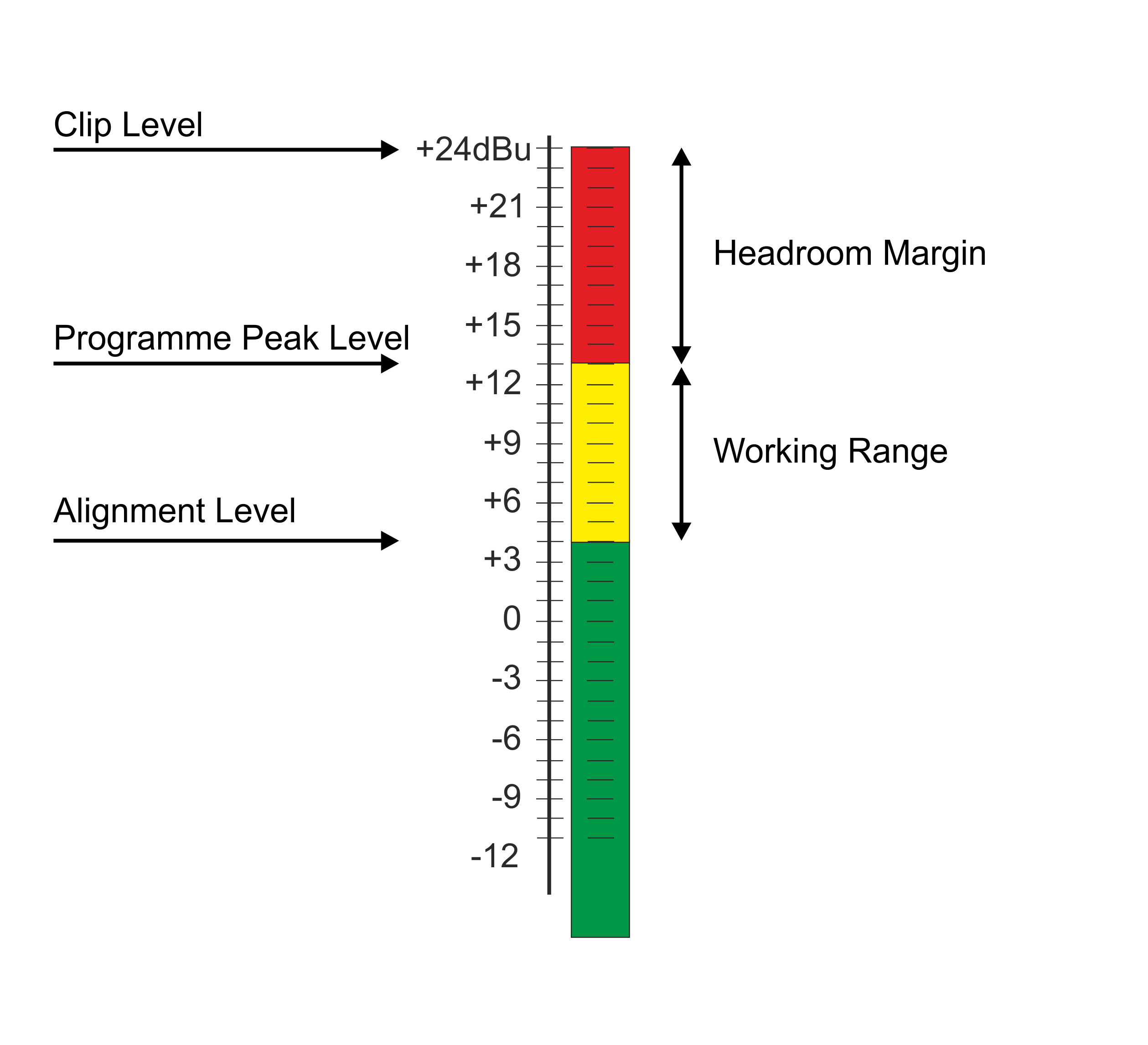

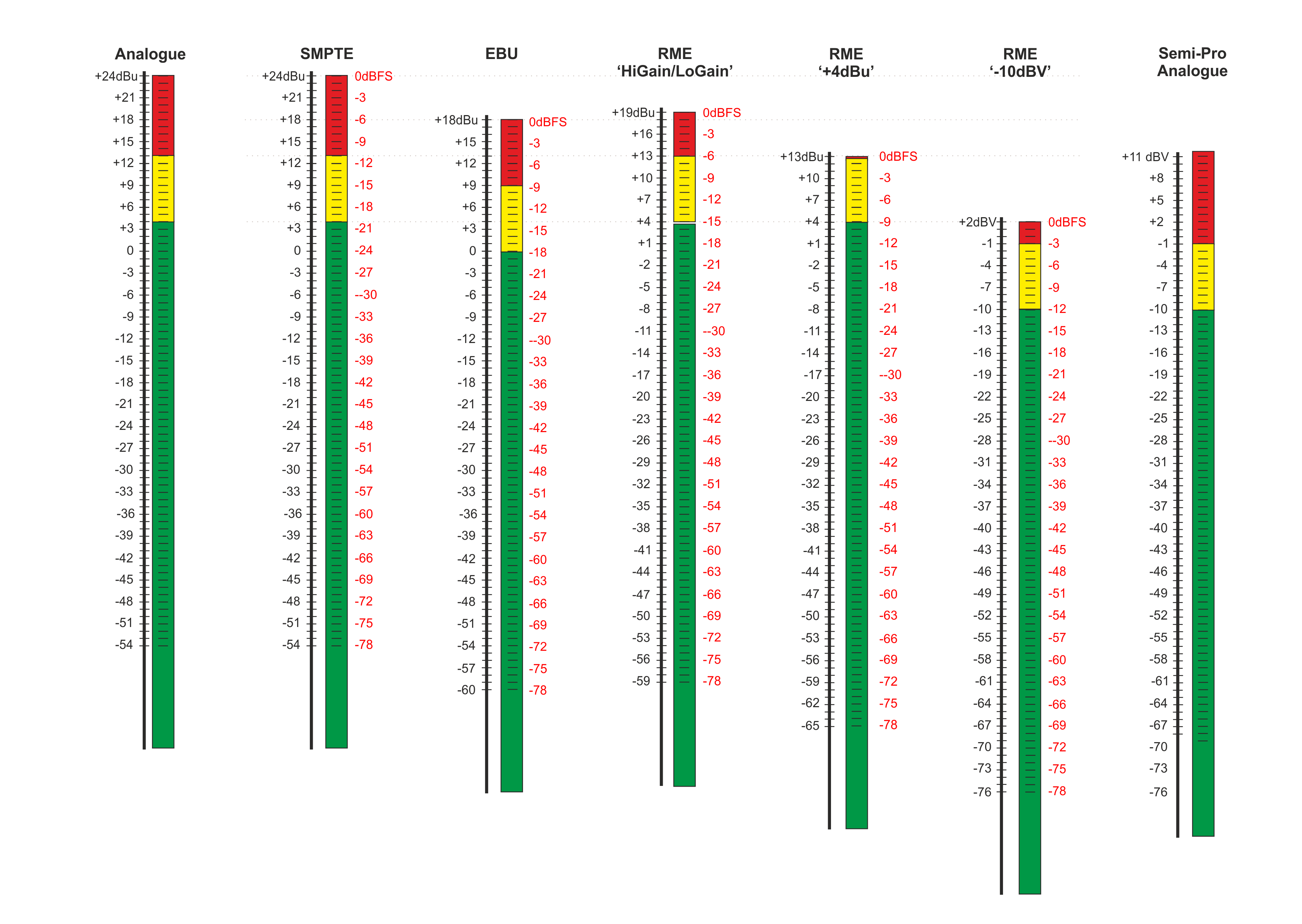

This is a case of 'yer pays yer money and takes yer choice'. There are plenty of converter and interface options and, by and large you get what you pay for... You've listed many good quality alternatives and we've reviewed a lot of them. If money is no object then it will come down to a personal preference of features, facilities and sound character -- some having more 'character' than others! Personally, I'd go for the Prism if someone else is bank-rolling it!
However, I fear there may be some underlying misunderstandings generating part of your desire for change:
You say '...have to run external equipment very low'? This is utter madness.
If you are concerned that the analogue levels are too low in comparison to your digital levels, you need to use a conversion alignment with a LOWER clipping level, not higher. Try switching to the +4dBu mode on the RME's analogue input and output settings instead.
The plain fact is that there are only a very few situations where a clipping point of +19dBu is a problem (and they relate to live recordings with no rehearsal and lots of unpredictability!), and it really shouldn't be bothering you to the extent you suggest.
A clipping level of +19dBu should provide more than enough headroom for any sensibly calibrated and operated analogue/digital signal chain within the controlled environment of a project studio. Thousands of broadcasters, studios, mastering houses, and project studios all across Europe seem to cope perfectly well with it... as do I.
The reality is that RME's adherence to the EBU standard is perfectly logical and practical given their Germanic origins. In fact they actually provide 1dB more headroom than the EBU alignment calls for (making precise alignment less critical).
It's also worth noting that -- and this is the REALLY important bit -- the EBU alignment provides 18dB of headroom (and RME are giving you 19dB) whereas the SMPTE standard calls for 20dB of headroom.
Are you really trying to tell us that 1 or 2dB more headroom margin would make a stunning difference to your system's sound? If you are I fear there really is something terribly awry either in your system's setup or its operation -- most likely your analogue reference levels are wildly incorrect or you don't understand the concept of headroom.
Have a read of this: http://www.soundonsound.com/techniques/ ... w-software

According to the manual, the DDA mixer’s “output capability” is +26 dBV (which I believe is the same as +28 dBu – correct me if I’m wrong).
Yes, you are correct. It is specified with a generous headroom margin befitting its live sound intentions... but that doesn't mean you have to use all of it; It just means it isn't going to restrict headroom in the overall system.
By default it is designed to operate with a reference level of +4dBu (= 0VU), but the versions fitted with PPMs were aligned for a reference level of 0dBu (=PPM4) -- this being the appropriate calibration alignment for use with EBU converters.
Since the FF800 maxes out at +19dBu, I have to run the mixer level low when recording in order to maintain adequate headroom in the digital domain and avoid clipping.
Well... yes, technically you should be operating with a reference level of 0dBu, so 4dB lower than the stock design. And in that case you'll have 19dB of digital headroom instead of 20dB, which isn't something I'd lose any sleep over. You'd also have 4dB less signal-noise ratio in the console, but again, not something I'd worry about in a project studio situation.

Switching to a converter that requires +24dBu for 0dBFS instead of +19dBFS will require you to push the analogue side 5dB harder for the same digital-side levels.. so I get your thinking... but I'd investigate the meter alignment in the DDA first because from your description that sounds the most likely problem to me.
Quick and easy calibration test: With the RME set to the +hi/Lo gain modes so it expects +19dBu for 0dBFS, use the desk's line-up tone or another source of clean sine-wave, and adjust the desk's main stereo output level to read an RMS average level of -15dBFS on each channel in cubase.

You're not alone in that! And part of the problem is understanding what is meant by the term 'headroom'...
Headroom is the space between the defined maximum working level of the system and the level to which normal programme peaks are allow to reach -- something which you or the manufacturer decides.
In the case of analogue equipment, the nominal 'alignment' or 'reference' level -- which is usually where the average level of normal signals sits -- is well defined. In European broadcast markets it is 0dBu while in professional recording studios it is +4dBu (in most cases). This alignment level is also shown as a reference mark on metering systems (eg. PPM4, 0VU, Test, etc).
In an analogue system, normal programme peaks are allowed to rise 8dB (in the UK) or 9dB (in Europe) above that reference or alignment level -- so typically, +8dBu for UK broadcast, or +13dBu for a recording studio (and on meters it would be PPM6 or off the red end of the scale on a VU!
So normal programme peaks would be expected to fall somewhere in the yellow region of that virtual meter above. The average level would be expected to sit around the transition between green and yellow, but obviously the quieter bits will fall down into the green area. Very loud uncontrolled transients might reach up into the read -- and the headroom is there to accommodate them without overload distortion.
However, the actual 'maximum working level' in analogue equipment can sometimes be a bit vague as the amount of distortion often increases progressively as the level increases, long before the electronics actually 'clip'. The sound character becomes progressively more 'crunchy' or coloured as the level increases and the meters go 'into the red'. In the days of analogue tape machines the nominal peak level was generally chosen to keep distortion at or below 3% THD. That's a lot when you consider most analogue electronics manage a THD figure below 0.001% without difficulty!
In practice, though, most high-end analogue equipment like mixing consoles and outboard gear will usually cope with +24dBu before clipping (and some may go even higher), so +24dBu is generally taken as the maximum practical pro-audio level.
So with analogue systems, the manufacturers specify a nominal alignment level, and the user is expected to allow signal peaks no higher than 8 or 9dB above that... knowing that larger transient peaks can still be accommodated albeit possibly with some distortion. Some users will want to avoid that increasing distortion, while others might actively make use of it for musical colour...
In digital equipment, the situation is very different. As the signal level rises the amount of distortion remains extremely low right up to the point where the converter runs out of quantising levels, and then it clips horribly and generates anharmonic distortion!
So the maximum allowable level is clearly defined here (0dBFS)... but sadly the manufacturers omitted to build-in an 'alignment level' like there is in the analogue world -- that's (unhelpfully) left entirely to the user's own preferences.
Having said that, SMPTE (in America) recommends an equivalent alignment level of -20dBFS, while the EBU (Europe) recommends -18dBFS... and mastering engineers working on high quality music might choose -15, or -12dBFS, or something else...
So that's 'headroom'.
Where this becomes important (and confusing) is in the analogue-digital calibration -- how we translate between the analogue and digital domains.
In general, it makes sense to choose a calibration that provides similar headroom margins for both the analogue and digital domains, so that neither one runs out of space prematurely and thus becomes the limiting factor when moving signals between the two domains.
However, that's not always practical, depending on the equipment you're working with. For example, semi-pro devices may well not have the same peak-level capacity as high-end professional equipment, and some European equipment designed to the EBU spec will not be fully compatible with American equipment designed to the SMPTE spec.
I have a new Rme Fireface UFX II and it is really my understanding that in low/high gain settings have 15db of headroom not 19.
RME products usually offer several selectable calibration options*, and on the UFX2 they are labelled as 'LoGain' and '+4dBu' on the line inputs, with the corresponding (if slightly confusing) 'HiGain' and '+4dBu' options on the line outputs. A third output alignment is labelled '-10dBV'.
Ignoring the -10dBV option for the moment, both of the calibrations (lo/hi and +4) assume a nominal alignment or reference level on the analogue side of +4dBu. The difference between them is that the lo/hi option is configured to reach maximum digital level (0dBFS) at +19dBu, while the +4 options does so at +13dBu.
So, relative to the analogue alignment level of +4dBu, the lo/hi mode has 15dB of digital headroom (19-4 dB), while the +4 mode has 9dB of digital headroom (13-4 dB). The manual is correct in that claim!
Just for completeness, the -10dBV mode provides 12dB of digital headroom, but its analogue calibration is designed to match the semi-pro standard alignment level of -10dBV rather than +4dBu.
It might make more sense, and help to put all this in context, to look at a graph:
So here I've shown the professional analogue world on the left, with the 'alignment level' at +4dBu on the border between the green/yellow sections of a virtual meter. I've shown the the nominal working range (normal signal peaks) as a 9dB window in yellow (to match RME's specifications), and the remaining headroom in red above that.
As you can see, the SMPTE calibration exactly matches the nominal professional analogue world.
For comparison, I've also shown the EBU calibration which uses an alignment level of 0dBu and a peak level of +18dBu. It obviously has 6dB less headroom than the SMPTE standard, and that's because it is expecting 'controlled' broadcast-ready audio where someone has already mixed and managed the sound levels, so there should be no uncontrolled transients, and less need for a large headroom margin.
RME's lo/hi gain calibration sets a maximum peak level slightly (1dB) above the EBU requirement but it can't go as high as the SMPTE standard. In practice, this is rarely a problem as only the most enormous uncontrolled transients would normally be affected... but it does mean that you may need to be a little cautious when setting levels when using high-end analogue equipment.
The RME +4 option reduces the analogue peak level even further, and is really intended for use with highly-compressed and commercially mastered audio where there is no need for a large headroom margin at all.
