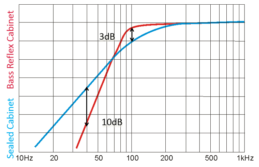

The other thing to consider is the type of speaker cabinet because that affects the roll-off rate or slope. The bass roll-off is much faster and steeper from a ported cabinet (typically) than a sealed cabinet, for example. So while the figures for a ported cabinet might appear to have greater bass extension (ie, a lower -6dB frequency figure) than a similarly sized sealed cabinet, the latter will still be reproducing audible bass at a much lower frequency than the ported cabinet because the bass rolls-off more gently -- as this diagram illustrates. Here the -3dB figure for the sealed cabinet might be 100Hz, while that of the ported cabinet is closer to 60Hz... but at 40Hz the sealed cabinet's output is some 10dB greater than that of the ported cabinet! So it's complicated...
