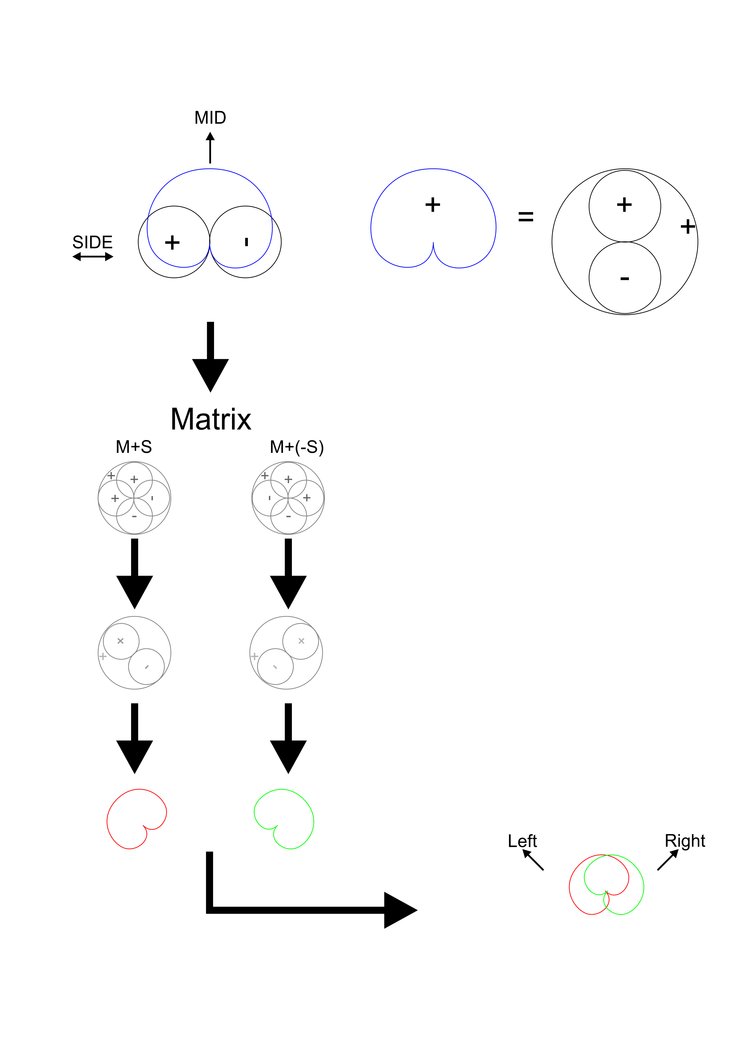

ef37a wrote:Hugh, maybe you could give us some (VERY!) simple algebra about MS and mic responses?
The algebra is very simple:
Left = Mid + Sides ...and... Right = Mid - Sides (or more practically) = Mid + (-Sides)
When teaching this stuff I find it often helps to think about it graphically in terms of polar patterns:
So in this example, the Mid mic is a cardioid, and the Side mic sensitivity is about 6dB lower than the Mid mic. The Side mic is obviously a fig-8, and we need to disassemble the cardioid pattern into its component parts which is equal sensitivities of Omni and Fig-8, with the fig-8 element facing front-back.
So when adding Mid and Side for the left output we have an omni and two fig-8s at 90 degrees to each other. They combine to a single fig-8 at 45 degrees, and when combined with the omni we're left with a virtual cardioid facing 45 degrees left. The same process for the right output produces a virtual cardioid facing 45 degrees right.
Changes to the relative levels of Mid and Side mics changes the resulting polar pattern and its direction... and differences in the two mics' frequency and polar responses have the same effect.
