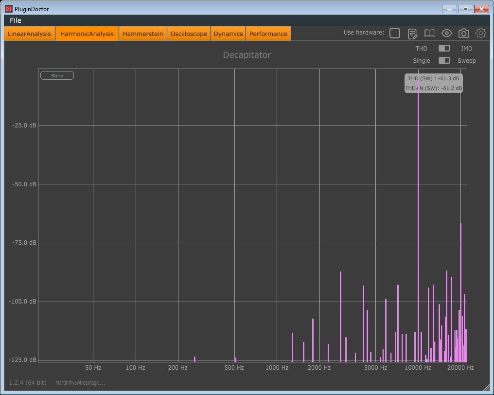

Re: YT vid 'explains' why analog emulations don't sound as good as they should? Any truth in this?
Dr Huge Longjohns wrote:since it's by definition designed to produce evil distortion
Not necessarily, to be fair. It models desk channels so you can choose to have a tiny amount of it. But Herr Snakeoil basically says it's always going to impart nastiness you shouldn't be getting because of its non-aliasing etc design? Does this mean one should always check the specs of an allegedly analog-modelled plugin very careful?
To some extent yes, but personally I think you have to judge with your ears in context.
Here for example I've just run up the wonderful Decapitator with a more subtle preset that emulates 'Neve Fizz'
With an 10kHz sinewave input at a level of -5dBFS, yes, you can see aliasing apart from the wanted 10kHz and 20kHz lines, but as you can see from the THD (Total Harmonic Distortion) figure of around -60dB, the distortion products are already at low 0.1% levels in total, while the highest aliased spike is at about -87dB (that's equivalent to 0.0044%) - not very significant in the overall context to my mind.
As always your likeage may vary from plug-in to plug-in, and it's well worth doing a few tests at higher frequencies to check for aliasing problems, but in practice I wouldn't rule out using Decapitator based on these figures
