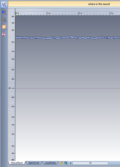

Like James, I downloaded your audio file and can confirm that it contains a DC offset sitting at about -51dBFS, as shown below:
^ thanks for the welcome and help guys this is exactly what I needed, to put a name to the problem. now I have a way in and will look into ways to fix this! :)
