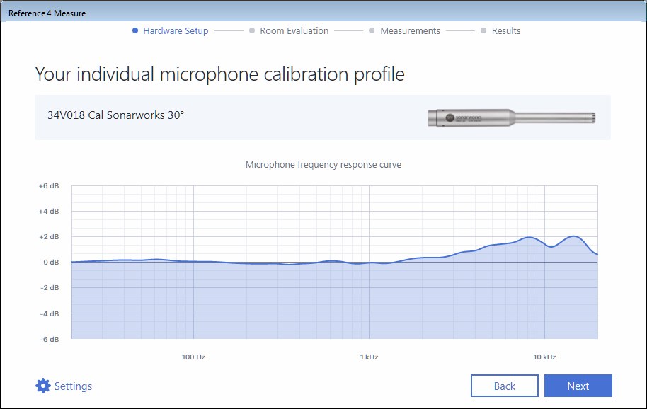

Each Sonarworks XREF20 measurement mic has its own calibration file, which by default is supplied in its own SWMIC format to be directly loaded into the Reference 4 Measure software, where it displays the response (here's mine for instance):
However, the calibration files can also be downloaded from this page, where they are supplied as a zip file containing both the .SWMIC and standard. txt format for inclusion into other software e.g. Room EQ Wizard etc.)
