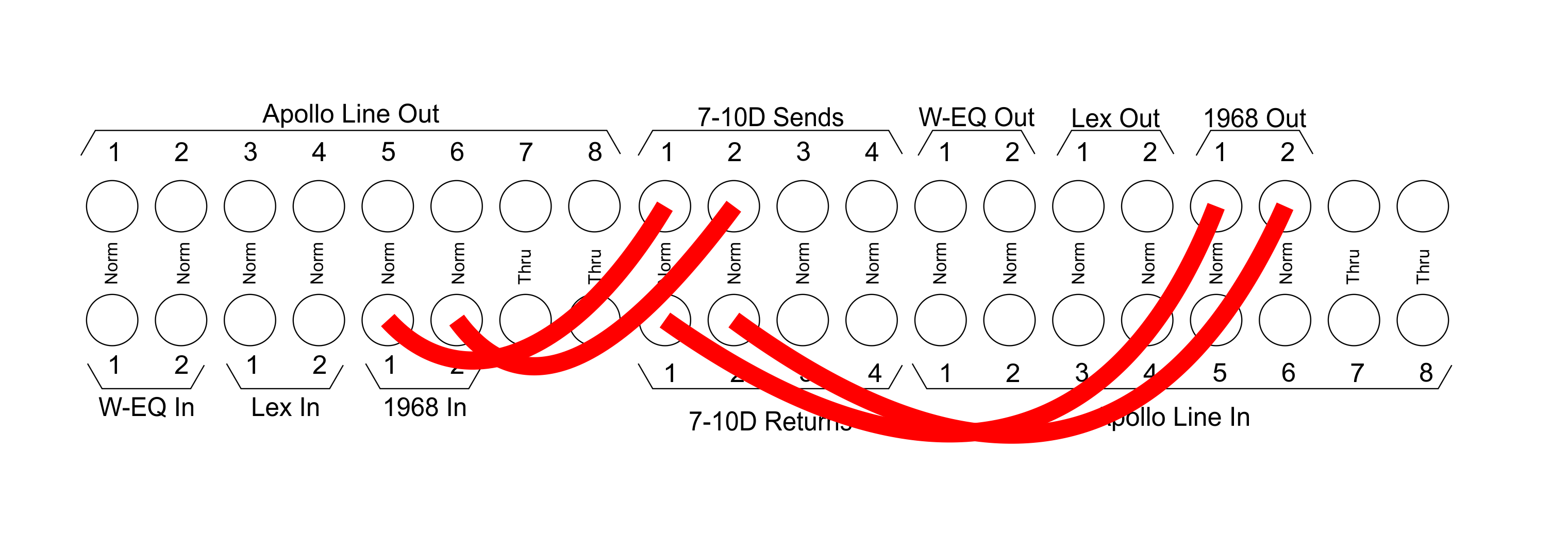

Thanks for the tips Hugh. The FX units I'm using are a pair of Warm Audio W-EQs, a Lexicon PCM92, and a Drawmer 1968 MkII compressor. The FX sends and returns are going to the line-ins/outs of the Apollo 8, via the patchbay.
As there are only 8 line-ins/outs available on the Apollo, I've been using ADAT to connect the 4-710D up to the Apollo for tracking, so at them moment there are no sends from the 4-710D going to the patchbay. My plan was to use the FX insert points on the 4-710D to patch in the external FX for tracking.
This system is now working (I've set the patchbay to 'normal'), sending the FX insert from the 4-710D to the front input of the patchbay, returning to the 4-710D from the front output of the patchbay.
If possible, I would rather not use the ADAT connection, but couln't think of another way to do what I wanted with the limited number of line-ins/outs on the Apollo 8. I'd also like to have the option of dong parallel compression for mixing, which I thought the patchbay would allow me to do. I'm sure there is a more efficient way to set this up!
This is the bit that's unusual -- you're patching the 7-10D straight across the FX units, rather than using the patchbay as a patchbay.
Here's the way I'd do it, with the FX units normalled to the Apollo line ins and outs, and the 7-10D inserts on other patchbay sockets. You then patch the FX units into the 7-10D with TRS patch cables when needed -- I've shown the Drawmer patched across the first two channels here, for example: Each socket pair is set to Normal, apart from any unused pairs (such as the line 7/8 examples here where I've omitted any normalled FX boxes).
If possible, I would rather not use the ADAT connection, but couldn't think of another way to do what I wanted with the limited number of line-ins/outs on the Apollo 8.
Well, you could bring the 7-10D outputs onto the patchbay as well (onto some top row sockets), and then patch them when needed into the Apollo Line Inputs. Or you could normal them instead of the FX units, and then patch the FX units when you need them... this is the whole point of a patchbay, after all!
I'd also like to have the option of doing parallel compression for mixing, which I thought the patchbay would allow me to do.
Parallel compression requires a mixing function, which is not something a patchbay can do. You need to mix the direct signal with the compressed signal -- very easy to do in the DAW, though.
Just send your signal out to the hardware compressor in the usual way, and then mix the return with the direct signal. Hey Presto - Parallel compression!
