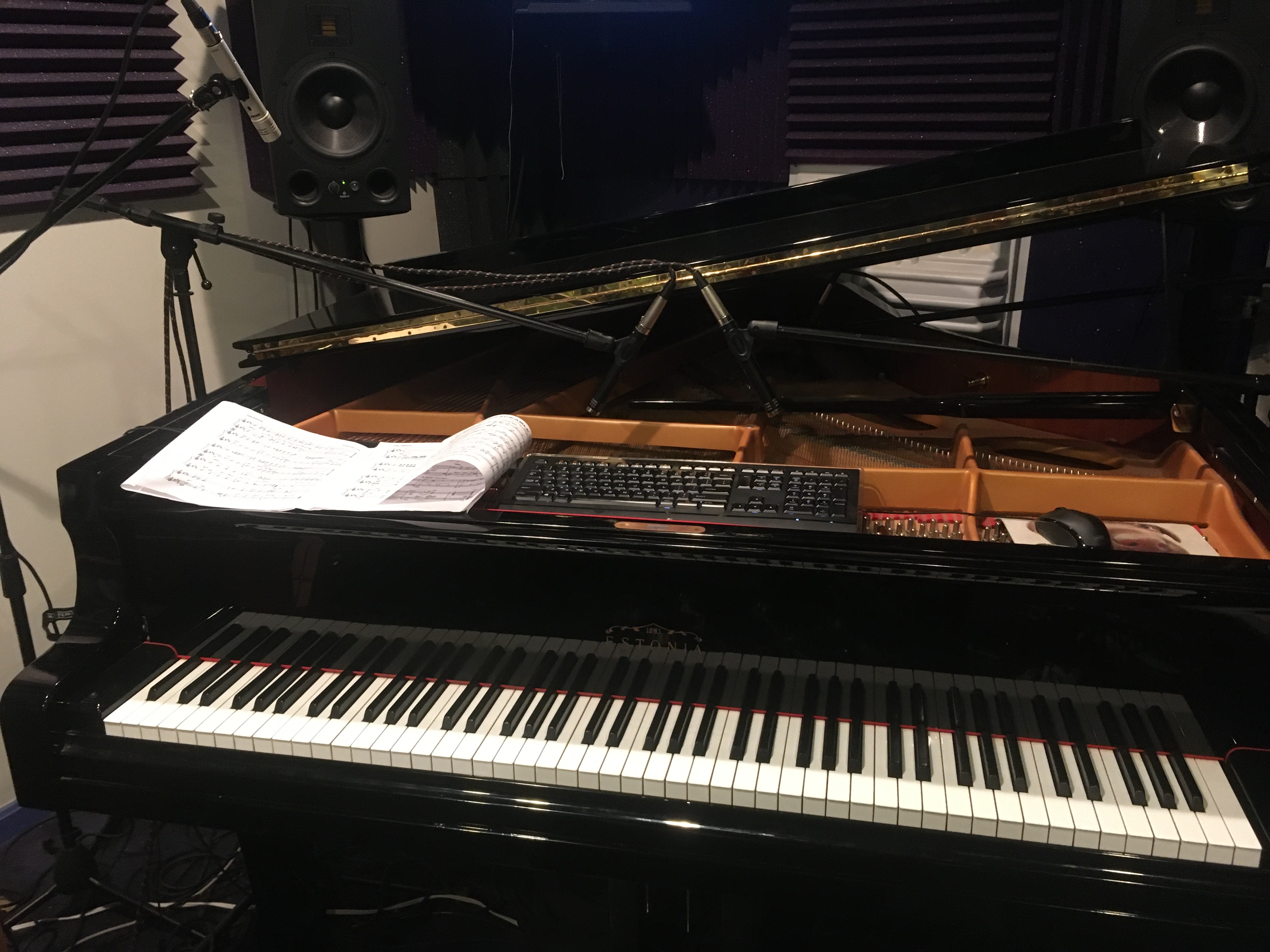

To get more bass, I moved the KSM 137 mic out from the sound hole. There is not a lot of bass there. I tried to get it inside the piano near the bass strings but then it is so close to the lid it starts to sound phasey in there to me. So I moved it outdside the piano, in front, pointed to the bass strings and found a spot that works.
Sounds pretty good to me now. This is all 4 mics now.
Pulsar II over the hammers (panned hard L and R)
PL-9 rear sound hole (panned hard right)
KSM-137 in front pointed at bass strings( Panned hard left) I am getting some natural bass tones now. I put a little reverb on this mic to simulate being in a live room.
Audio sample:
https://drive.google.com/open?id=1qmwg7 ... 1hw-P86ruW
Picture of setup:
https://drive.google.com/open?id=1aOIt3 ... LqHyhn7fRc
It's still amazing to me how the recorded piano actually sound nothing like the real thing. I can play back what I play right away and hear the difference sitting at the piano. The recorded piano is pleasant, just completely different than the real thing.
Audio sample:
Picture of setup:
I appreciate you guys giving this a listen with fresh ears and letting me know how it reads.

A bit late coming to this, but as Hugh said earlier I'd be very surprised if you couldn't get a good sound using two good mics in optimum position.
Listening to the latest sample, and not being aware of how the piano sounds live, it's not that great. I'm hearing harsh middy string sound (on the right), bass is not as full as I'd expect and that softness of tone from the higher notes is lost beneath the 'stridentness' of those notes.
So, assuming the piano is well-tuned, I suspect you need to move the mics further away from the action. I don't suppose you have access to a pair of neutral omni mics?
My approach to recording piano is to use either a spaced pair of Omnis outside the body with lid on the long stick (for more classical styles, of an ORTF pair or A/B pair of a neutral condensers (TLM193) at closer quarters. Omnis will extend to capture any bass the piano can provide, and you could use them closer to the strings but being careful to not get close to the action.

Was that example without any processing in post?
It sounds a bit over reverberant to me so the acoustic is having some effect?
On the other hand it may be the sound of that piano. Pianos can sound very different even if the same make with sequential serial numbers.

Re: Please help recording grand piano to eliminate phasey sound
Pianos are like the human voice, you don’t really know how they sound until you’ve recorded them.
I can hear a tuning issue with that piano, that may be making the situation worse.
My ultimate advice would to use just a stereo pair, and experiment with positioning, if you want a darker sound, I’ve used omni's at the foot of the piano on a stereo bar, with good results in this respect.

It's hard to tell from the image, but that piano looks like it's tight into the corner of the room which really isn' going to help with the tonality. It's quite possible the midrange prominence is a room effect.
And if you are suffering room issues, throwing more mics into the pot is likely to make things worse rather than better.
In that situation I'd be inclined to switch to contact mics on the soundboard (Schertler, for example) and a fistful of EQ...

My two penn'eth: There are obviously some tuning issues with the piano which are a little distracting, and the room is clearly affecting the overall tone too. The stereo hammer mics are extremely right-heavy, but when tweaked for a more balanced sound aren't actually too bad if you want that hammery sound. Great for cutting through a busy mix!
I don't know if the right offset is a gain calibration, placement, or a playing issue... or maybe you want a right-heavy balance for the mix?
The PL9 isn't really bringing anything useful to the party, and sounds rather 'sound holey' so it may be in too close... but even so it's not bringing anything that the KSM isn't.
The KSM does bring some welcome weight without the boxy sound of the PL9 or the clatter of the hammer mics.
As you said don't want more mellow and less hammer, I'd ditch the hammer mics altogether. Keep the KSM for now, and experiment with just one other mic to bring out the mid/top either from close in over the strings or from just beside the piano somewhere in the curve towards the keyboard midway between the case and lid. Distance, height and (if you're using a directional mic) angle of this mics often makes a significant difference to tone.

Listening to it again and looking at the photos, my feeling is that with the piano shoehorned into that room with the wall very close, it would be extremely difficult to get a reasonable sound. What would the same piano played with little or no room contribution sound like. I cant be sure. It would be interesting to hear it.
