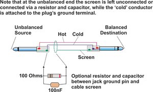

Sam Spoons wrote:Some keyboards have balanced outputs but most do not, if yours does then balanced TRS cables are worth using, if not there will be no benefit and, as with guitars, they may not work at all.
However, if you're routing unbalanced keyboards into a mixer or audio interface that has balanced inputs, it's also possible to make up a special pseudo-balanced cable that may result in lower background noise if it breaks a ground loop.
SOS did at one time offer their own specially made leads through their on-line shop, although sadly they can no longer get them made: https://www.soundonsound.com/help/sos-special-cables
So, most people have to solder up their own - here's a handy diagram that encapsulates what you need to do:
pseudo-balanced cable image.jpg (23.96 KiB) Viewed 1289 times
I've made up quite a few over the years for my own small studio, where they are perfect for connecting mains-powered (and earthed) keyboards/synths to already earthed mixers/interfaces.
