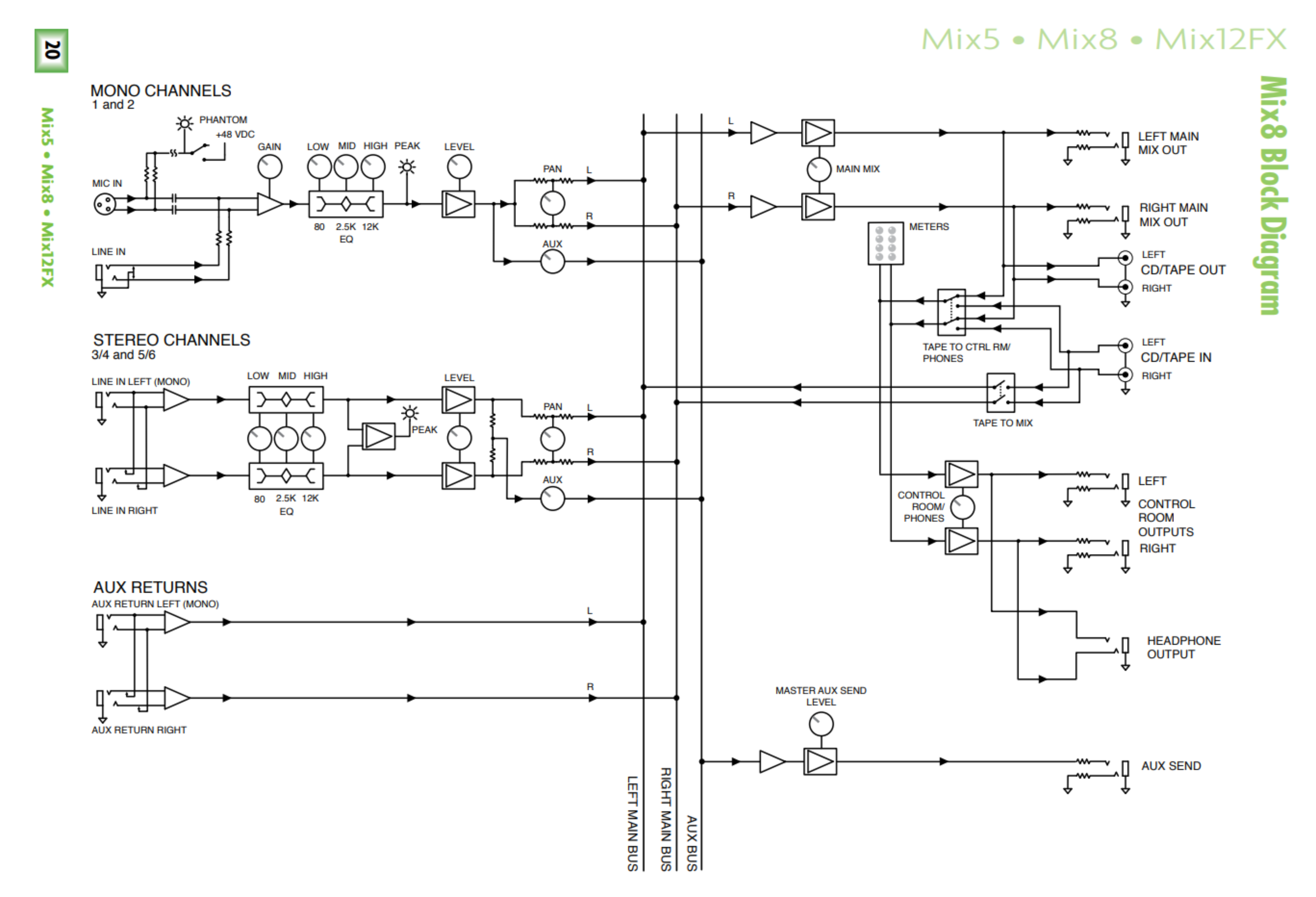

The left input signal is normalled to the right input, so plugging in to just the left socket will provide a 'dual-mono' signal through the channel path and it will behave just like another mono channel strip.

There is no legend screen printed on the mixer like there is on my 1202VLZ and it's not very clear in the manual, no mention in the paragraph about line inputs only a mention in the "Bal/Pan"section which I missed first time I looked.

I agree about the lack of panel labelling and ambiguous wordings in the manual -- although the function is implied in a few places... but as always, the easiest, most accurate and fastest way of figuring stuff like this out comes from the block diagram which shows the stereo channel normalling very clearly:
