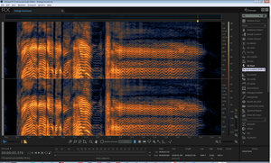

Here's a spectogram of your recording courtesy of iZotope RX6, zoomed in to show the octave from 6-12kHz.
As you can see, there is a lot of audio signal extending up to almost 10kHz, but it all exhibits the same vibrato rate and depth, as well as the same amplitude envelope. This suggests it's all from the same source, rather than a sympathetic resonance from something else in the room or microphone, or a distortion product.
If this high frequency content is not to your liking, then I'd suggest trying some alternative microphone positions with a view to minimising the capture of such strong HF elements. I'd start by raising the mic to forehead level and point it down towards the mouth. That will help to reduce the sound element emitted through the nose which tends to have more HF elements. You could also try moving the microphone sideways -- basically try anywhere that's not directly in front of your mouth!
You could also try a different kind of mic if you have one available -- I'd recommend not using a capacitor mic. A ribbon might help, or a moving-coil mic with a smoother frequency response.
And using EQ to remove the offending elements is also an option, of course -- but do so before applying any compression or other processing!

Hugh, I will follow your advice and see what happens. I would never have hoped for such a detailed quantitative analysis and I'm really impressed. It also helps me grow my general knowledge.
And while I was already writing down all this, I tried an experiment that I considered to be pointless and perhaps it wasn't. I recorded the same 4 seconds on my phone and ignoring the hisses and noises it picked up, I do hear the same resonance, so yes, it is probably my voice, as you guys suggested. I guess I'll have to work on my technique and on my very limited equalising skills.
