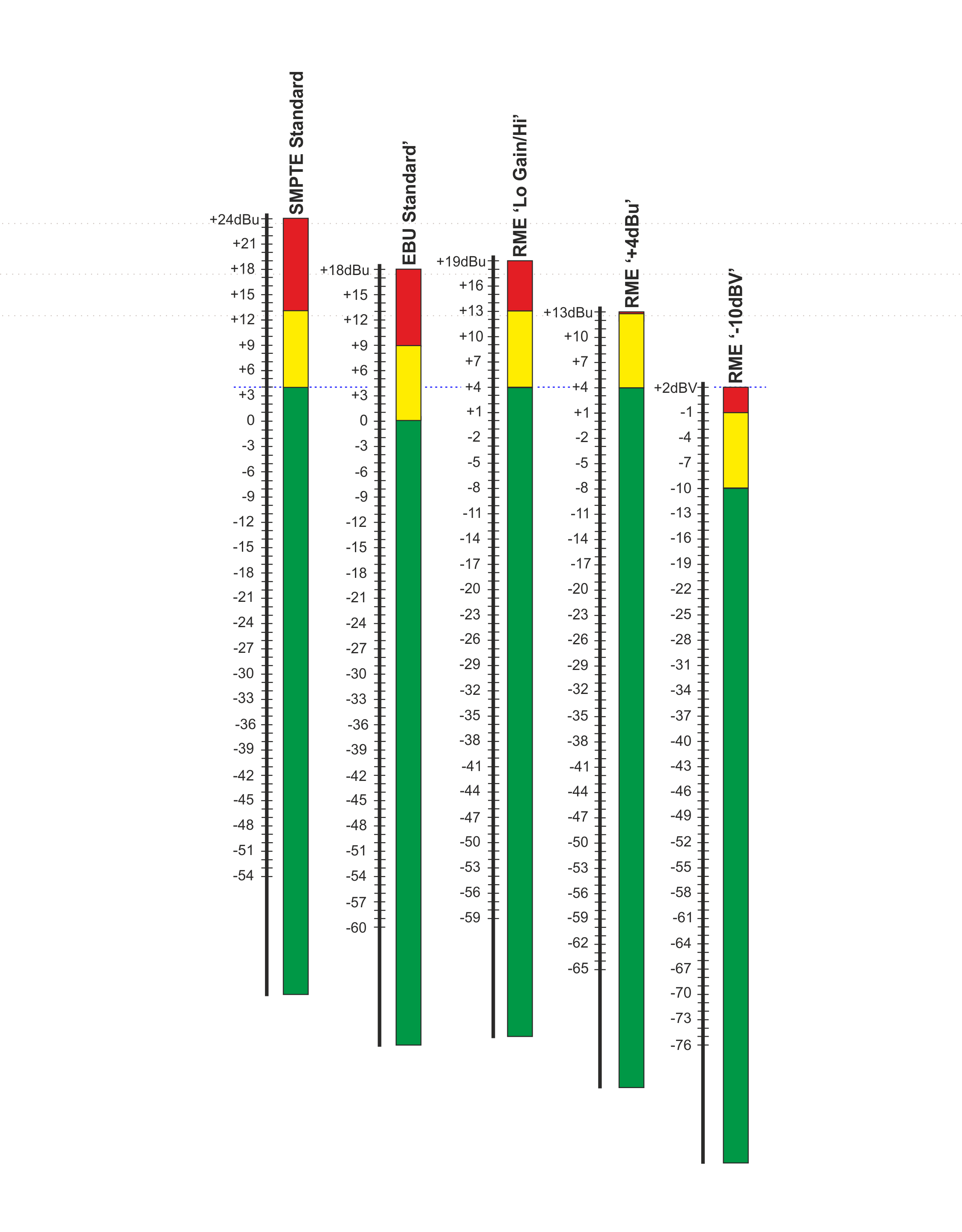

Ah I see I should clarify a bit, I actually have an RME UCX if that makes a difference.
There are 3 different input sensitivities for the analog inputs but even at the lowest setting I still get clipping whilst recording some vinyl, and get nowhere near the -20dBfs range for all.
TheBev

It might help if you gave us details of the whole signal chain as I would have thought that it would be very difficult to get anywhere near the UCX's max input of +19dBu with a domestic hifi system.

TheBev wrote:I actually have an RME UCX .... There are 3 different input sensitivities for the analog inputs but even at the lowest setting I still get clipping whilst recording some vinyl...
As James says, we need to know the signal chain because there aren't many consumer RIAA preamps that can push out peaks over +19dBu (which is the clipping level at the UCX's lowest sensitivity setting). A professional one could, though, on click transients at least.
This chart compares the three RME analogue sensitivity options with the SMPTE and EBU recommended alignments. As you can see, the +19 option on the RME actually matches the EBU broadcast standard (with an extra 1dB safety margin!), but I've shown it here with the SMPTE alignment level of +4dBu instead of the EBU's 0dBu since that's what most home studios operate with!
(The yellow region on each bargraph indicates the 9dB nominal programme range between the Alignment Level (green/yellow border) and the Maximum Permitted Level (yellow/red border), with the red area above showing the different systems' headroom margins.
