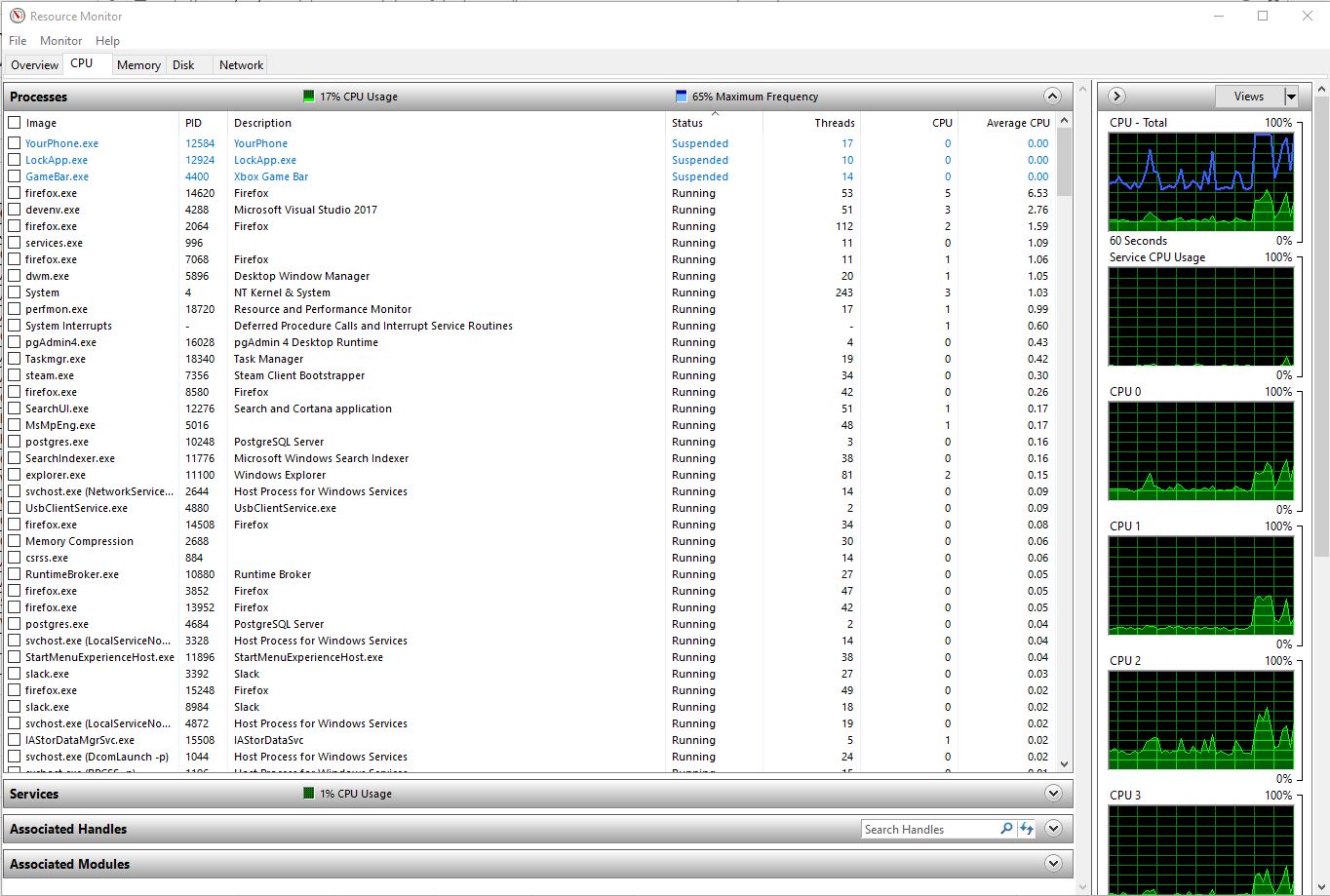

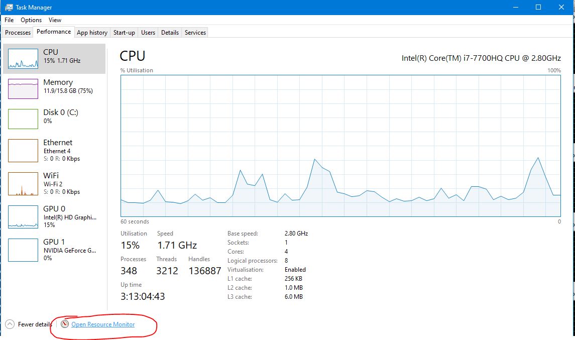

You can confirm this by clicking the 'Performance' tab in the Task Manager and then clicking 'Resource Monitor' at the bottom of the window:
Once in the the Resource Monitor, click the 'CPU' tab and it will show you a breakdown of each individual core. If there are one or two cores running at high load and the rest are relatively idle that would confirm that Studio One is not using all the cores for the workload you are asking of it in the DAW:
If this is the case then I'd suggest the best thing is to contact their support, provide details of the stuff you're doing in Studio One (how many tracks, how many and which plugins etc.) and ask them to advise further.
