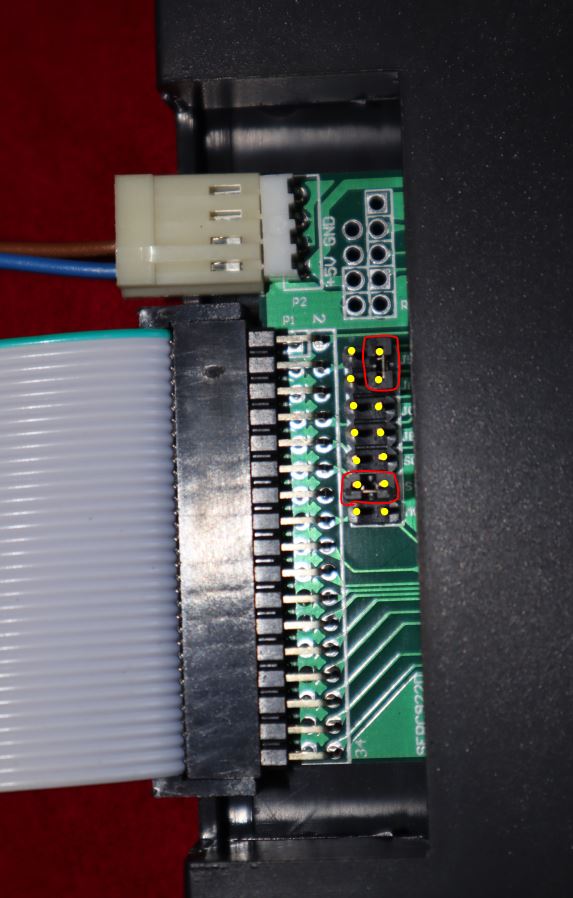

Regardless of which of the above emulators you are using, you will need to change the jumpers on it before installation such that Drive 1 is selected (the default is Drive 0). To do this, set the jumpers as shown in the picture below:
The above picture shows the SFR1 M44-U100K connected to the Trinity - note that the stripe on the IDE cable is at the end nearest the power connector.
The above jumper settings will disable the Drive Ready signals from the SFR1 M44-U100K-R, but as I said before, the Korg Trinity doesn't work with them anyway and if they are enabled then it won't see the disks on the USB stick.
