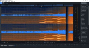

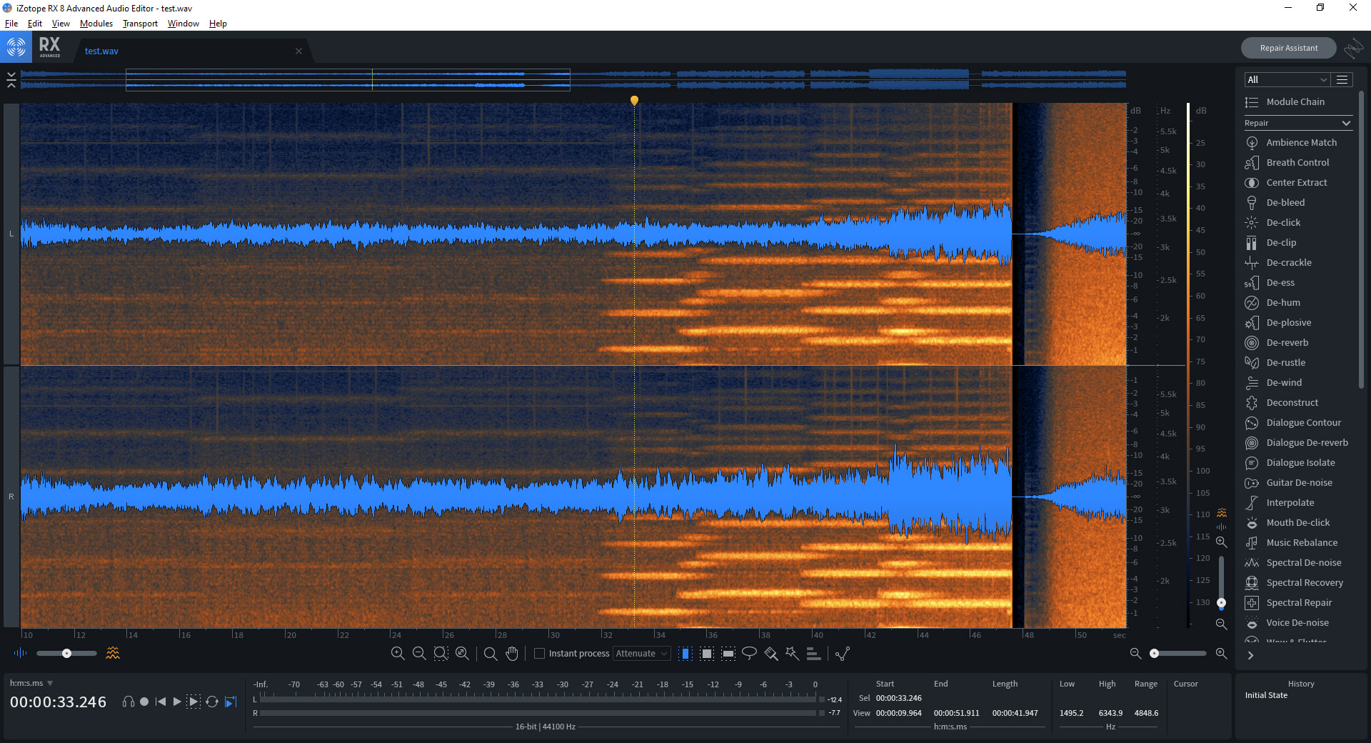

I just had a listen and I can't hear any clicks or pops.
However, when I download the sample file and view it in a spectrogram, after a bit of messing about with the display settings I can see loads of big clicks throughout the file. Curiously, though, even though there are dozens of them clearly visible, virtually none is audible. I only hear anything on one of them and then it's just a tiny click almost buried in the programme at the kind of level where it could almost be a case of hearing what I'm seeing or there just being a small acoustic or electronic click coincident with the line on the spectrogram, rather than anything actually being there. I spend a disproportionate amount of time messing about fixing clicks on things and none of these sound as they appear on screen, assuming they sound at all.
There are some random things going on but the obvious issue in the first two bits is an even click happening with regular timing. I'd guess that someone along the chain is mis-clocking. Is everyone running at the same sample rate? (It appeared as a 44.1kHz, 16bit WAV file for me.) In the last clip the clicks appear all over the place. As if it's been through multiple passes of whatever is causing the regular click in the other ones.

Thats very interesting. I have asked a few people now if they can hear and they have said they can. But the people on the guy mastering it's end said they couldnt. My first guess was our sample rates and bit depths were different but I am pretty certain we are running all of our tracks at a sample rate of 44.1khz and a bit depth of 16 now. I asked another friend about an hour ago, who mixes and masters his own stuff, and he said he hears them - and that it could be related to one of the plugins having a issue with aliasing? I think I mentioned in my last post, I have only ever heard this clicking or popping in the DAW itself and never in exported tracks, but this is usually when the buffer size is too big or too small. Thats the only reference I have to the clicks, so I dont know if that helps narrow it down to aliasing or not.
But, if you're saying you can see them in a spectogram but cant hear them, that means they are embedded into the track right?

There are definitely clicks all over those test file tracks, and they are embedded in the source. They are very visible in a spectral display, such as on RX, as thin vertical lines, mostly evident in the high frequency areas.
As was said above, their regular nature and the fact they tend to occur on one channel or the other suggests something digital wasn't being clocked correctly, but it's impossible to say from this viewpoint whether that was at the source recording, mixing, or mastering stages.
It would obviously be prudent to carefully check your source and mix files to see if the clicks were present there, but if not a discussion is required with whoever did the mastering.
