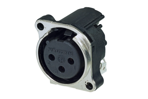

Adam Hall sell assembled cables using components from other suppliers... often low cost Chinese look-alikes in my experience.
No brand name on the HEDD sockets I'm afraid. Why would there be ?
Quality manufacturers usually have an identifying logo — Neutrik always have an N logo embossed on the insert, for example, and in the example below, the full name too.
It sounds like you've been very unlucky that the dimension tolerances of plug and socket were off a bit too far.

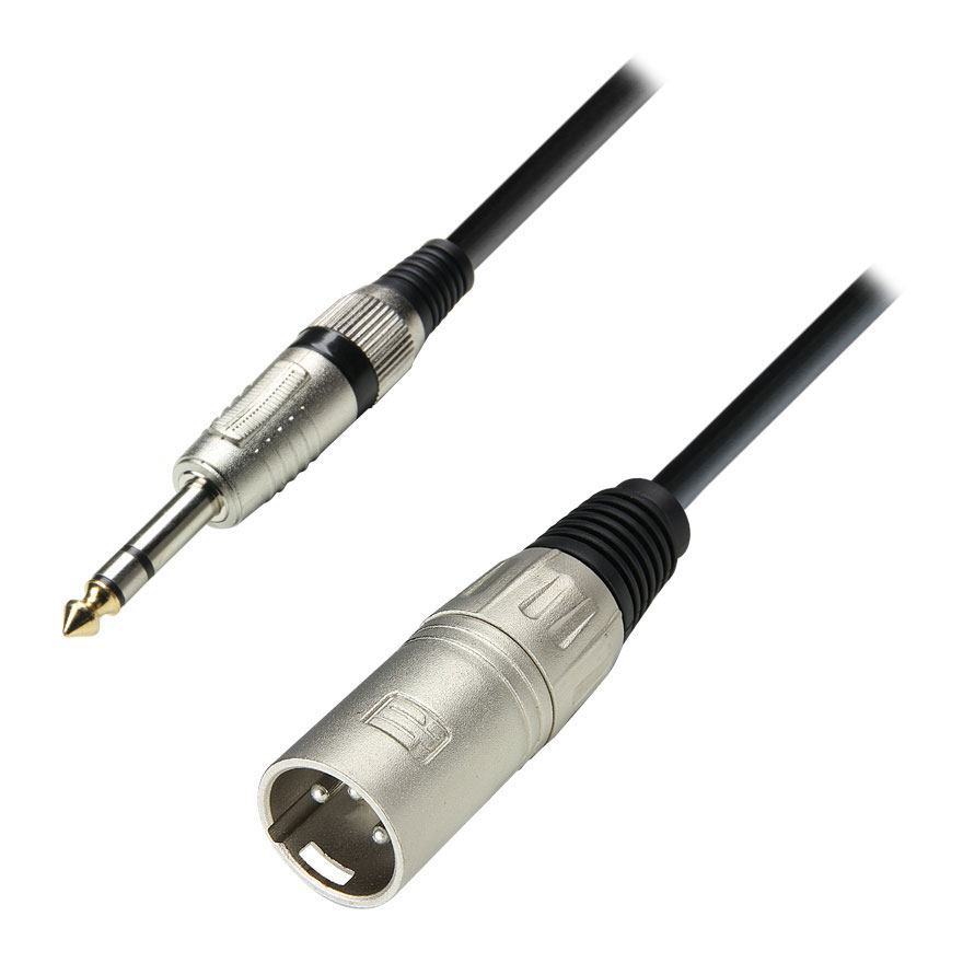

The Adam Hall cables in that package are from their 3-star range using Neutrik look-alikes. List price is just over $10 per cable. Their 4-star range use Rean connectors and 5-star use Neutrik connectors.
I’d get cables with better connectors.

Security features are no match for my mighty copy and paste function.
They look like genuine NewTricks, should come apart if asked nicely.
Just rip the tab and the locking mechanism out of the socket before you fit it. Loads of devices have non-locking female chassis sockets and the world still turns.
I've recently been doing just this with some old DMX lights, one out of five didn't work out but that was a practice one, like pancakes. I'm sure you're more patient than me.

Re: How To Release A Stuck XLR Connector?
shufflebeat wrote: ↑Wed Jun 28, 2023 11:00 pm
They aren’t Neutriks. They are cheaper look-alikes. Cheaper than Rean. See my post above.
It doesn’t mean they aren’t the same dimensions, you’d have to measure them to check. But they aren’t Rean and they aren’t Neutrik, so they could be the problem.
Wonks wrote: ↑Wed Jun 28, 2023 11:21 pmshufflebeat wrote: ↑Wed Jun 28, 2023 11:00 pm
Apologies, my subtle irony may have been missed, they're obviously not Neutrik. Apparently they are single-use XLRs but can possibly be surgically removed by the processs I described earlier and disposed of humanely.
Worth noting, I suspect it's the chassis sockets that are the main culprits.
Your subtlety beat me too... but for the benefit of others, they lack the Neutrik name or logo — one or both are always on the real items. Also, the logo on the XLR is clearly not the Neutrik logo.
These are clearly knock-off imitations... the body grooves and cable clamp plastic are also different if compared to the real thing.
I wouldn't be quite so quick to blame the sockets in the speaker as I've witnessed trouble with AH cables in other situations...
