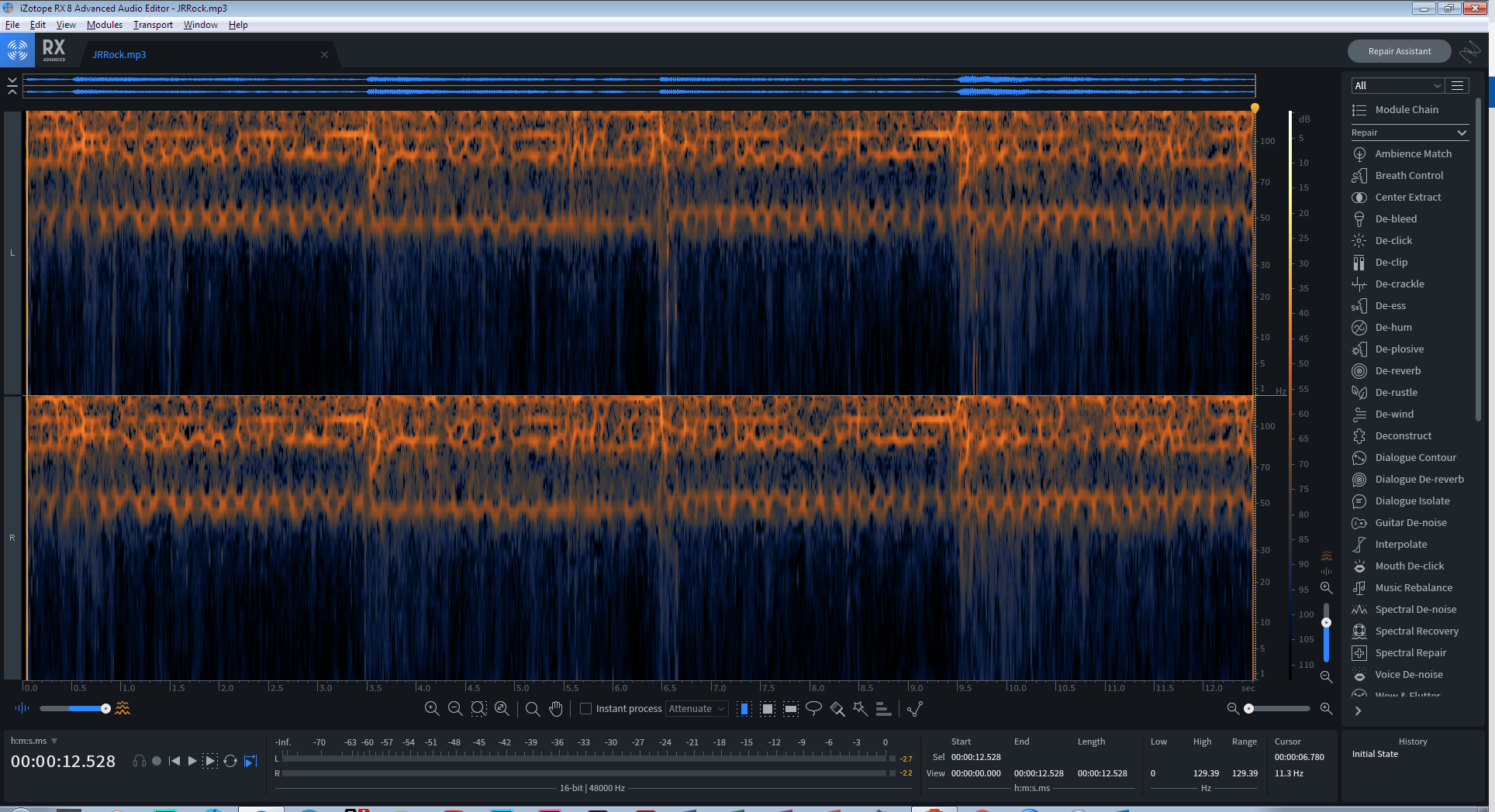

If you look at that clip on a spectrograph or spectrum analyser, there are transients at each chord change with frequency components that go right down to single-Hz. There's also quite a bit of stuff floating around all the time in the 45 - 55Hz area.
Both of those are the kind of elements that will upset some speakers.
Here's a screen grab from RX8 with the (vertical) frequency scale showing the range from 1 to 200Hz. You can see the strong horizontal line at 50Hz-ish, as well as the vertical transient spikes on chord changes that go all the way down...
For the record, though (and ignoring the odd noise-burst at the beginning), your clip plays without any nasty (unintended) noises on all of my systems here.

Re: Sound issue in mix playback
Hi Hugh,
Thanks for your reply. So does that mean that the Alesis speakers can't handle the 45 - 55Hz area? Which I assume means, they're not best suited for anything 'too bassy' and I should get myself a different pair that have a better frequency range and that do handle that range comfortably?
JRocker wrote:Thanks for your reply.
I've just added a screen grab to that previous post so you can see what I'm talking about.
Not necessarily. It may simply be that something in your room or the speaker is resonating or rattling because of the strong energy at those frequencies.
As I said, screws can work loose. Objects can start to rattle sympathetically. Pulsing air flow through ports can cause internal connecting wires to bounce against speaker chassis...
You'll need to work through your system carefully to find the culprit.
The earlier suggestion to feed one speaker at a time while lifting it off its support is a good place to start. If the noise goes away you'll know the noise is related to a mechanical vibration through the stand. If it doesn't then it's a speaker issue. Try leaning the speaker back so it's pointing at the ceiling. Does that change anything? Check all the screws are tight -- does that help? ...And so on.
Well, if everything points at the speaker having a problem then it might be worth considering something more capable.
But equally, it might be worth tweaking the mix to remove the problem energy -- so high pass filtering at 40Hz, say, would help with those transients, and it maybe that a modest notch around 50Hz will help tame those deep rumbles which probably aren't really adding anything useful to the mix.

Looking at Hugh's screenshot there seems some heavy, complex modulation going on there, patterns I've not noticed before on the RX screen, and I use it regularly. I can also hear what sounds like the rattly/clicking sound (maybe 5 to 10 Hz modulation frequency) but not nearly as prominent as in the mobile phone recording.
It makes me think of how a vinyl record struggles with reproducing certain complex waveforms and a good engineer makes sure those complex waves are dealt with to avoid reaching the cutting stylus.
I agree with Hugh that certain sounds are not too agreeable with speakers but I also wonder if many such sounds are actually pleasing to the human taste anyway, this sound being an example. The sound, however it was concocted, is just not pleasant to this pair of ears. When the guitar chord came in - and partly masked the previously exposed sound - I felt relieved.
