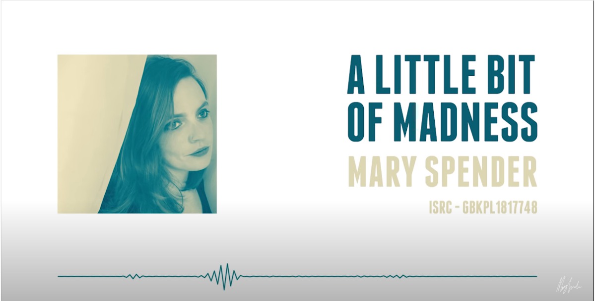

Another thing I find illuminating when I feel I'm 'reaching the limits' is how creatives re-interpret existing songs by other musicians. Here's one that fascinated me recently.
Here's the original song - 'A Little Bit of Madness' by talented UK guitarist/songwriter/blogger Mary Spender.
CLICK HERE: https://www.youtube.com/watch?v=wQ0jeROHZJM

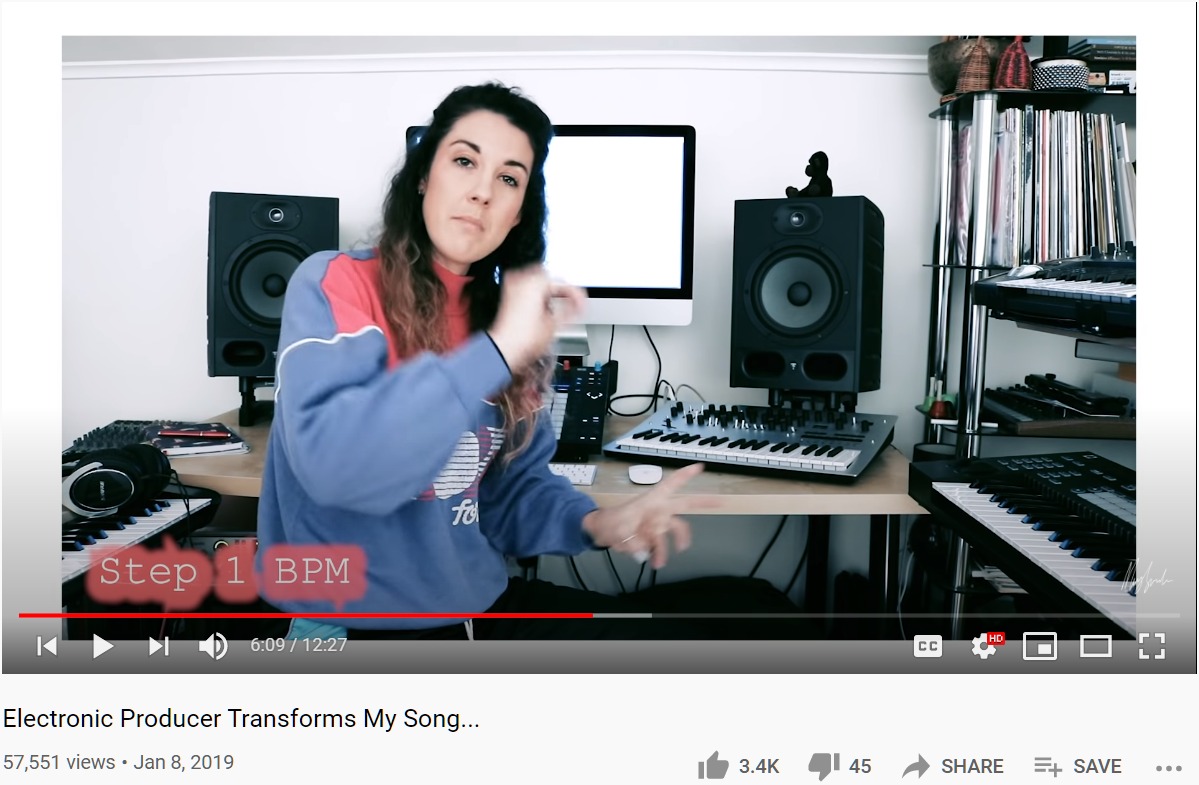

Now listen to the remix from Electronic Producer Rachel K Collier (including details on how she put it together).
CLICK HERE: https://www.youtube.com/watch?v=ENxZSZLOnRE
As I say, really inspirational (to me anyway

Re: Reaching the limits?
...creatives re-interpret existing songs by other musicians...
This is very clever, but it doesn't sound anything like the original which I personally prefer, but that doesn't matter really.
I just can't help thinking that we are watching (metaphorically) someone taking a draft novel of the Famous Five and turning it into a blood and guts action thriller.
I'm also very worried about the amount of room treatment on that producers front wall. I mean shouldn't there be more rockwool and sand?
Joking aside, it makes me uncomfortable, but I'm sure it pays some bills.
Albatross wrote: I'm also very worried about the amount of room treatment on that producers front wall. I mean shouldn't there be more rockwool and sand?
Possibly the speakers are there for show and most of the work happens with headphones?
CS70 wrote:Albatross wrote: I'm also very worried about the amount of room treatment on that producers front wall. I mean shouldn't there be more rockwool and sand?
Good point
But seriously, who would do that to promote serious work?
Martin Walker wrote: Now listen to the remix from Electronic Producer Rachel K Collier (including details on how she put it together).
Sorry for off topic, but I want to know which speakers are these, isn't that PreSonus? ANyway, I'm a little bit familiar with them, so just wanted to know, if anyone knows...
