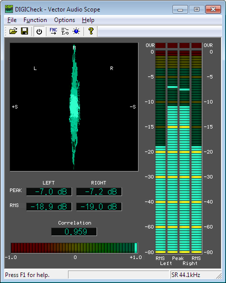

Re: It looks my mix has no enough distribution by panorama. It looks too concentrated near vertical line
AMusicPlayerPlus wrote:Why it happens that the total mix is too concentrated and not spread on panorama?
It certainly is narrow.
Here's a screen-grab from an RME vectorscope showing the actual track, and it never gets any wider than this:
If you listen to the stereo difference signal (which reveals the stuff extending to the sides of the stereo image) the loudest thing in it is the weedy synth string bed, and that's not faded up far anyway. The slightly panned harpsichord-like twiddles appear in there too, but not very high because they're not panned very wide.
If you want a wider, more impactful stereo image you are going to need to get a lot braver and deliberate with the panning of those occasional sources that pop up occasionally in the mix.
So I'd push the harsichord-ish sounds out much wider, and you could make much more of the marimba-like elements too, leaving the centre clear for the flute lead, bass and drums -- although the cymbals could also go much wider.
I'd also be tempted to spread out the pseudo-brass parts with different parts on each side (try recording individual lines and pan them, rather than just whole block chords, for example).
You could also place a mono reverb of widely panned sources on the opposite side to the source itself to aid the impression of width. And spatially spread the parts which are playing musically against each other out to opposite sides. Don't be afraid to pan 100% left/right.
Last edited by Hugh Robjohns on Sun Apr 18, 2021 12:44 pm, edited 1 time in total.
