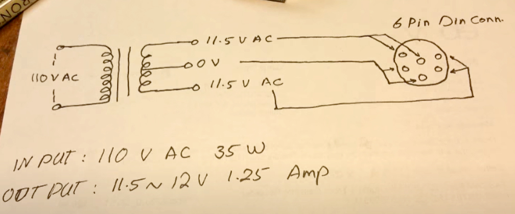

The original PSU used a simple transformer delivering 12-0-12 AC...
...but I have seen it suggested that the two 12V AC supplies were coupled via diodes inside the 424 machine simply to provide sufficient current (1.25 Amps), and a single 12V AC supply of sufficient rating can be used instead. I can't confirm this as fact, but it seems plausible given the video evidence, and the fact that all the related machines employ a single 12V AC supply.
There are some further details available in a video here: https://www.youtube.com/watch?v=KJHnCeztynY&t=89s
So if you can't find a UK PSU -- and I can't find any after a quick google -- your best bet is probably to modify a standard beefy 12V AC adapter as suggested in that video, or have a custom 12-0-12 supply made for you.
A decent tech should be able to figure out the correct wiring if they disassemble the machine.

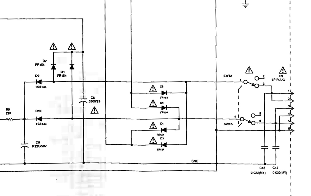

So here is the wiring of the 6-pin DIN:
Pins 1/2 carry one 12V supply, pins 3/5 carry the other, and pins 4/6 carry the centre tap/ground.
But the two supplies are summed through diodes to provide a single 12V AC supply internally, so a single 12V AC supply would actually work as well, if beefy enough.

Hugh Robjohns wrote: But the two supplies are summed through diodes to provide a single 12V AC supply internally, so a single 12V AC supply would actually work as well, if beefy enough.
I've not read the manual but your circuit diagram shows 4 outputs to me - one of which is -16V-ish while the others are +16V-ish (assuming that there are smoothing capacitors on the wires that go off page.
Posts: 16990 Joined: Mon Sep 10, 2001 12:00 am
Re: Tascam 424 MKIII UK replacement power supply
James Perrett wrote:Hugh Robjohns wrote: But the two supplies are summed through diodes to provide a single 12V AC supply internally, so a single 12V AC supply would actually work as well, if beefy enough.
I can see only three connections for two outputs, as Hugh said. I guess the paralleled terminals on the 6 pin connector are to double current handling capacity.

Tim Gillett wrote: I can see only three connections for two outputs, as Hugh said. I guess the paralleled terminals on the 6 pin connector are to double current handling capacity.
There are two inputs and a ground on the input connector but definitely 4 outputs going somewhere else on Hugh's diagram.
A quick look at the full manual shows that one goes to the +9V regulator, another goes to the -9V regulator, another to the +12V line while the last output is some kind of control signal.

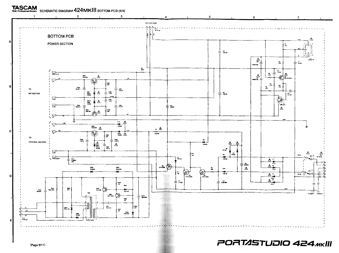

The full service manual is on the link I posted above and the PSU is shown on page 23 (or 25). Here's the full page:
Of the two lines going up the page from my cut-out picture, one carries a lumpy 12V to feed an IC regulator generating +9V, and the other goes to a discrete regulator circuit producing -9V. The two lines extending left pass 12V to another board and to another 5V regulator, as well as to a DC/DC converter that generates 27V and feeds a power-down sensing circuit.

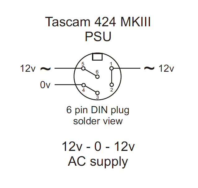

John Godsland of [url=www.http://orchid-electronics.co.uk/]Orchid Electronics[/url] has just written to me to say that he was able to help the OP with his missing power supply problem and has very generously provided an accurate diagram of the connector wiring details:
Orchid Electronics wrote: [The OP] did contact me about making a suitable replacement PSU for his Tascam 424MKIII tape machine - and after finding much conflicting information on the web, some erroneous - and some with drawings NOT showing DIN plug pin numbers, I can confirm that the attached PDF drawing is accurate and does work correctly with the machine.
Most suppliers stock a suitable toroidal transformer - a 30VA model with 0-12, 0-12 windings - which will be fine.
Can you please be so kind as to share this diagram so that anyone can find accurate information, now and in the future.
