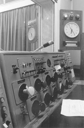

The real reason the BBC used faders opening towards the operator is entirely logical.
The early broadcast consoles, like this Type B desk, used rotary faders -- big knobs that you operated by rotating your wrist. They were fast and accurate, but you could only operate a maximum of two at a time. Then someone came up with the idea of a 'linear fader' with a pivoted arm which dragged contacts across an arc of studs, each connected to a chain of resistors to make an adjustable balanced attenuator. (Note the two microswitches which operate at each end of the fader travel.)
This arrangement allows a lot of faders to be placed next to each other so that several could be operated with separate fingers, allowing multiple channels to be balanced simultaneously, and allowing far more channels to be controlled in a compact desk.

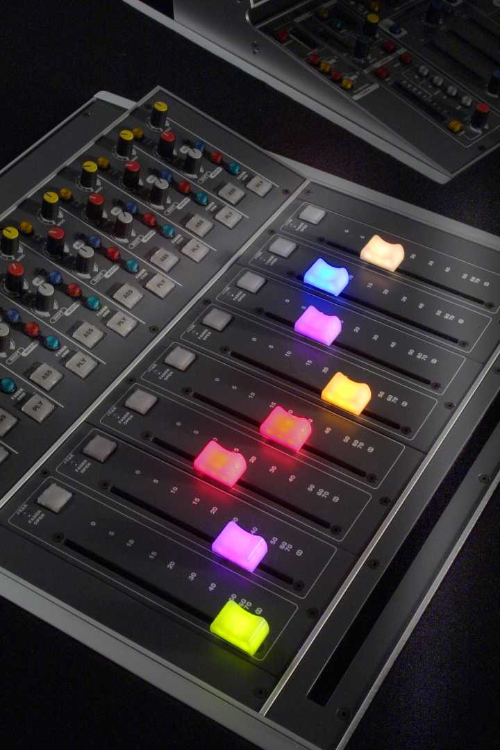

Another nice feature of those Painton quadrant faders was that they could be fitted with lightbulbs at each end to illuminate the perspex cover. That could be used to indicate active channels or, when different colour bulbs were used, to indicate channel group routing (or other functions).
This was over forty years before Studer decided to 'invent' the idea of coloured fader slots to indicate channel routing etc, and patent it as 'FaderGlow'... (Now also seen on some Soundcraft digital consoles too)

As for the ‘fader glow’ you can also find it on some newer Calrecs too…

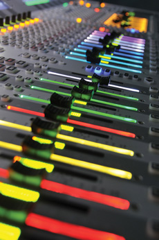

Ah... well... there's an interesting story there.
I don't know what the current situation is with Calrec, but I believe Studer tried to prevent Calrec from using their coloured ID strips alongside the faders by claiming the patent they somehow were granted on their own 'FaderGlow' system covered Calrec's system too because it was conceptually similar (but physically completely different).
Studer's engineering of the FaderGlow system is quite clever and typically Swiss. But I still struggle to understand how they could claim FaderGlow as a unique invention when the concept of electronically selectable coloured, back-lit faders or fader slots or fader escutcheons, as an aid function identification, pre-dates their design by nearly fifty years, and with at least four practical implementations of similar schemes in existence in the UK alone!
The first implementation of the idea that I know of was with the Painton faders, as already discussed. The next I know of was when SADiE introduced coloured virtual fader slots to indicate different fader automation modes in V3.0 of their DAW, which was around 1996. One of the nicest implementations of the concept of changing fader colour to indicate function was from Audix Broadcast (UK). They showed a really clever and fully functional prototype system in 2001 where the actual fader knob changed colour. Sadly, AFAIK no commercial product was ever made with their technology. Calrec's system on the Apollo desk (as in the image above) was around the early 2000s, as in your picture and it used a strip of multicoloured LEDs running alongside the fader slot.
In contrast Studer's FaderGlow system uses an end-lit perspex strip mounted inside the fader slot.

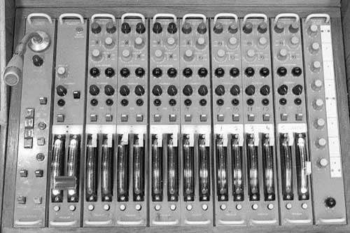

Re: Buying microphone cable, 100m drums.
Actually, not that hard to maintain. All discrete components on relatively spacious circuit boards in well-engineered chassis, and wonderfully detailed comprehensive service manuals still exist.
This is a section of a BBC Type D console -- the type I did my first live broadcasts on:
And here's a typical* channel module:
*This particular module is supposed to be from an EMI console, but it is uncannily similar to the BBC Type D...

Hugh Robjohns wrote: ↑Wed Jul 28, 2021 11:00 am One of the nicest implementations of the concept of changing fader colour to indicate function was from Audix Broadcast (UK). They showed a really clever and fully functional prototype system in 2001 where the actual fader knob changed colour. Sadly, AFAIK no commercial product was ever made with their technology.
That looks great. I did a few shows on a Soundcraft console with the FaderGlow system and was amazed at how effective it was. I initially thought it was a bit of a gimmick, and it's probably not for everyone, but my brain loves a bit of colour coding and it really helped find my way around when changing between banks/scenes etc.
