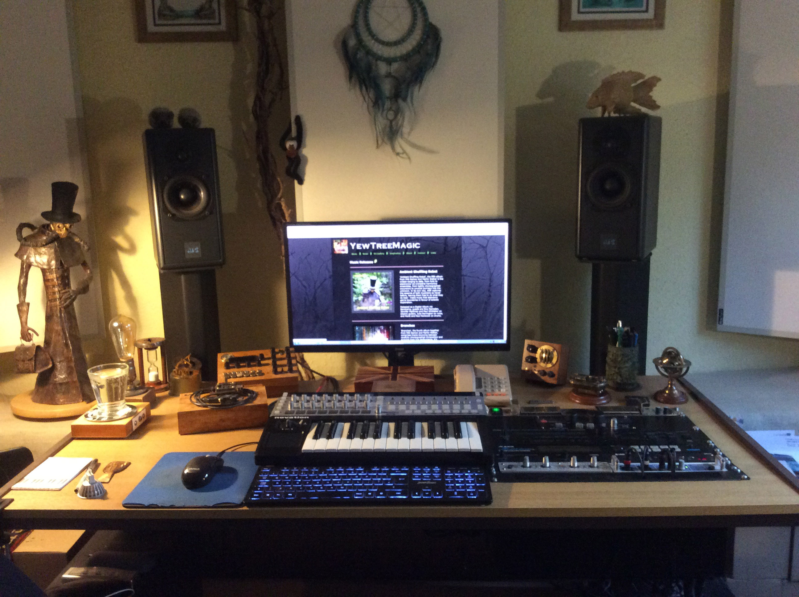

Re: What size screen do you use? (thinking about acoustics)
Not sure I understand entirely Martin.
My desk is like so:
I'm talking about replacing the top shelf (that the monitors and monitors are currently sitting on) with a new one, in the same place, but which extends backwards another four or five inches in the centre. This way the screens can sit further back without making any other changes to the desk or the monitor position.
(P.S. ignore the little desk off to the left, was doing some podcast recording for work).
My desk is like so:
Posts: 29388 Joined: Sun Jul 05, 2015 12:00 am
