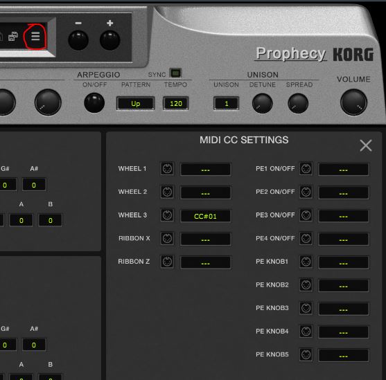

By default, CC#1 maps inversely to negative Y values on wheel 3 in the VST (ie: as you increase the CC values, wheel 3 moves 'down' from centre). I don't know what CC is required to move wheel 3 up though.
You can modify the MIDI controller mappings in the VST by accessing the global settings (via the little hamburger icon to the right of the preset name):
Through this I was able to assign a controller but this maps to the full range of movement on wheel 3 and you need a centre-sprung controller if you want to maintain the central default position of wheel 3 (if that makes sense). Also, assuming you're using a 7-bit controller then wheel 3 will most likely move in steps of 2 so you'll lose some of the range of expression (which may audible in certain situations).
As wheel 3 has a Y range from -127 to +127 I agree it's strange that there aren't two CCs configurable for it, one for positive and one for negative, especially as it seems likely that the default mapping is for two controllers.

Thanks for the info Eddy. I got a reply from Korg, saying that they have no plans to make sounds backwards compatible with the hardware.
I replied mentioning this wheel 3 problem. It just seems weird that you can define 2 controllers in the Arp page but only 1 in the global settings.
Reason can be a bit weird when it comes to controllers anyway. I shall post when I get a reply from Korg.
