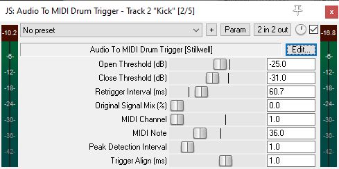

These are the settings that I've used on one of my projects.
Ah…okay, so… i’m assuming that’s a thing for converting audio into midi data?
That’s quite a cool process!
That could well be of help, thank you, but what do I do with this new midi information?
I mean, how will I get that midi information to “fire off“ selections of multiple samples of, say, a bass drum based on how hard it would’ve been hit hadn’t been’ really there’ as opposed to ‘virtually’, please?

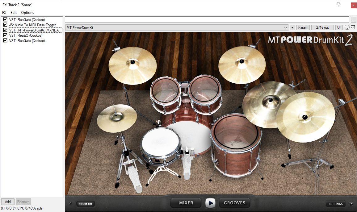

Let's assume you're using MT-Power Drum Kit (MTPDK). You'd stick this on a new channel and send the midi signal only from the other drum channels.
This is plays off the midi triggers generated by that JS plug-in. The key thing is that the output from the JS plug-in (unlike ReaGate) is velocity sensitive. The louder the original sound, the higher the midi-signal sent.
So when that midi signal reaches MTPDK it's not just getting an on/off message it's getting a variable signal for each hit, based on the original playing. So the louder the original hit, the harder the sample that will be triggered in MTPDK.
So if I was doing this I'd take separate midi feeds from the audio snare, kick, and toms and send them to MDPDK and use the faders in that plug in to add in the additional sampled sounds. Checking the phase at all points naturally.
If you've got a clear signal on the hi-hats you can do the same there, I'm not sure how effective it would be on overheads but you'd have to play around with that a bit.

For simplicity, I tend to have separate instances of MTPDK on each track rather than combining the MIDI signals as Drew suggests. This makes it easy to apply different processing to different parts of the kit.

I’ve done most of that but I’m not sure how I should get that JS effect to send midi data to the second channel/track
Do you have any suggestions?
