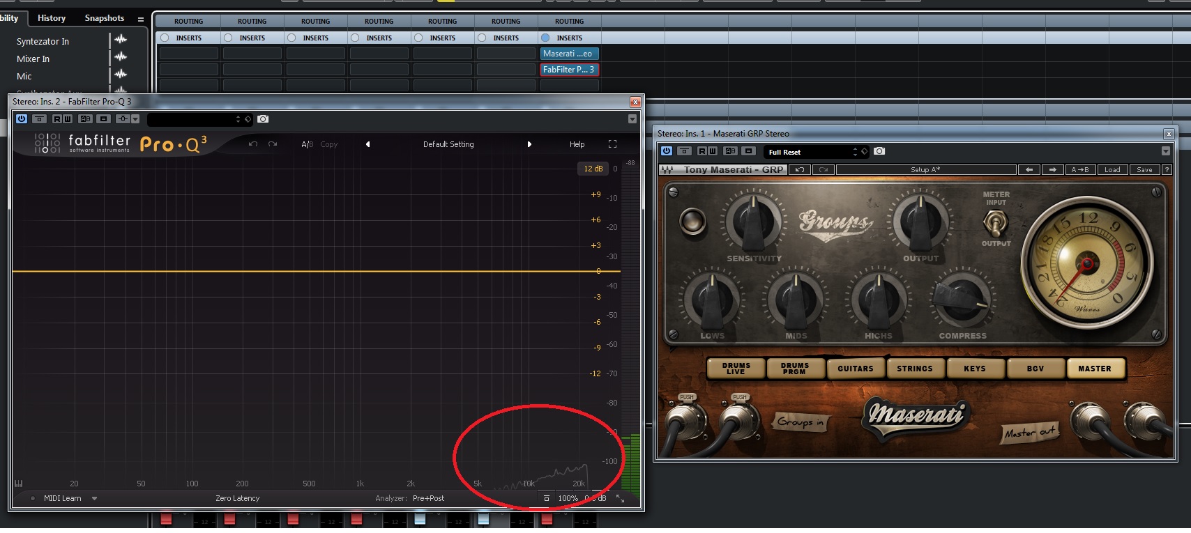

Hi All,
Question, why when I'm placing Waves "Maserati GRP Stereo" PlugIn in the "Master mode", and then placing FabFilter Pro-Q3, the EQ indicates some noise between ~7k and 20k?
Is this noise goes also to the final mix?
How to avoid it?
Please advise.
Thank you!
Screenshot: https://drive.google.com/file/d/1LhRRZU ... sp=sharing

If the plug-in is modelling hardware, then the hardware may well produce such noise, so the plug-in also produces it as it is part of that hardware's sound.
It may also be some aliasing noise due to upsampling within the plug-in and a less than perfect filter when it downsamples the output.
But look at the actual noise level. Even at 20kHz it's at less than -100dBfs. You simply won't hear it.

Because the Maserati plugin adds a chunk of 'air eq', and you can see the effect of it on the system noise floor.
Yes.... obviously... but (a) even at 20kHz it's still below -100dBFS so completely inaudible and (b) it will be completely masked by the music.
How to avoid it?
Take out the Maserati plugin.
