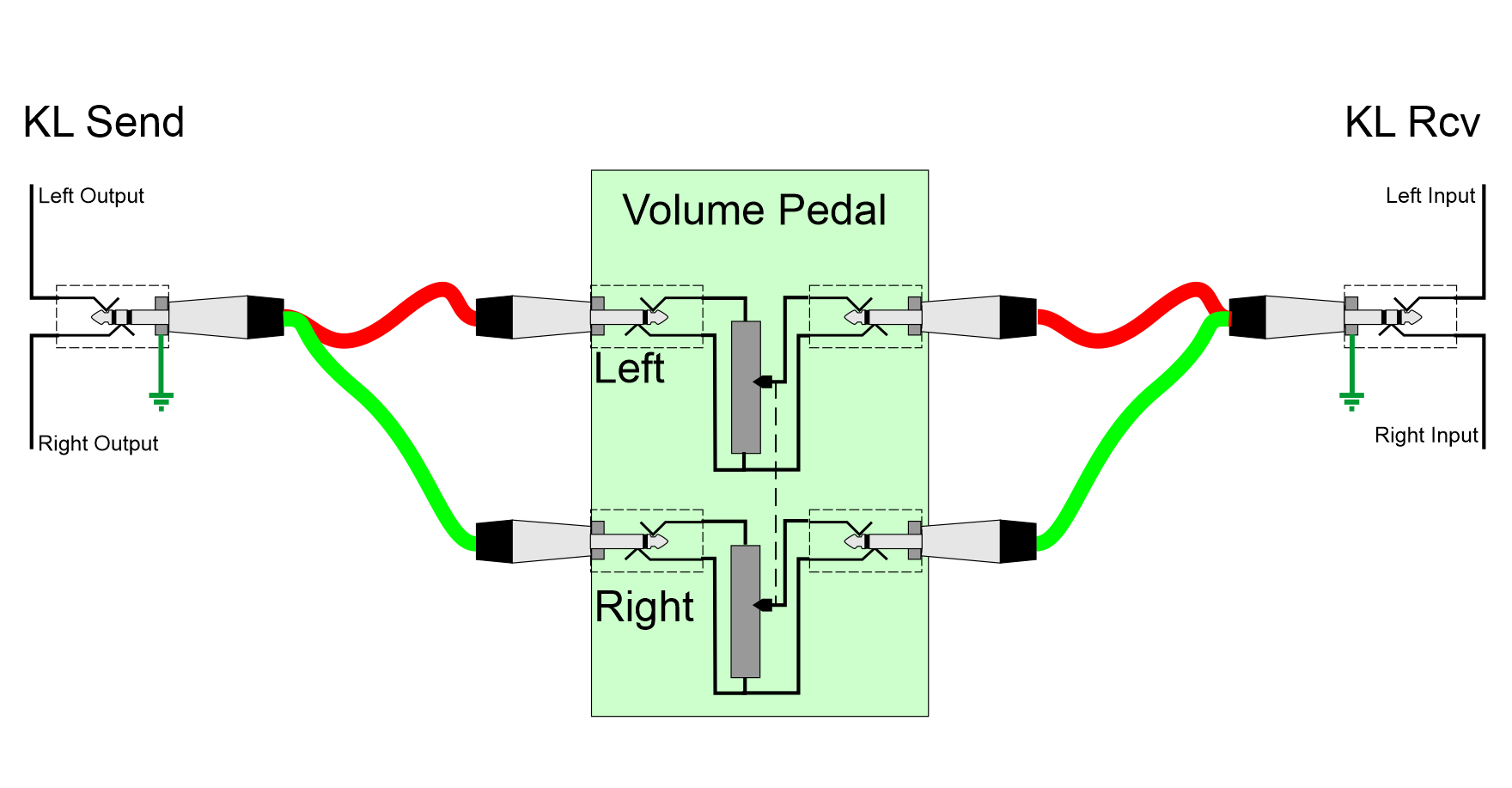

The KL requires a stereo volume pedal with a 25k Ohm (audio taper) dual pot. The mixed audio through the KL is routed out through the pedal and back, so it needs to be a good quality pedal with a quiet and reliable pot. Radial recommend an Ernie Ball 25k stereo pedal, but its very expensive.
Personally, I'm not a fan of this approach, though, as you can only control the level of the whole mix, not the balance of each instrument. Instead, I prefer expression pedals connected directly to each instrument, and these are usually much less expensive and less problematic.

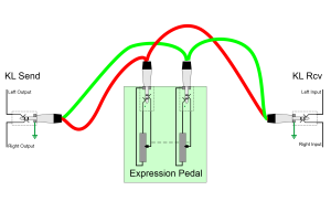

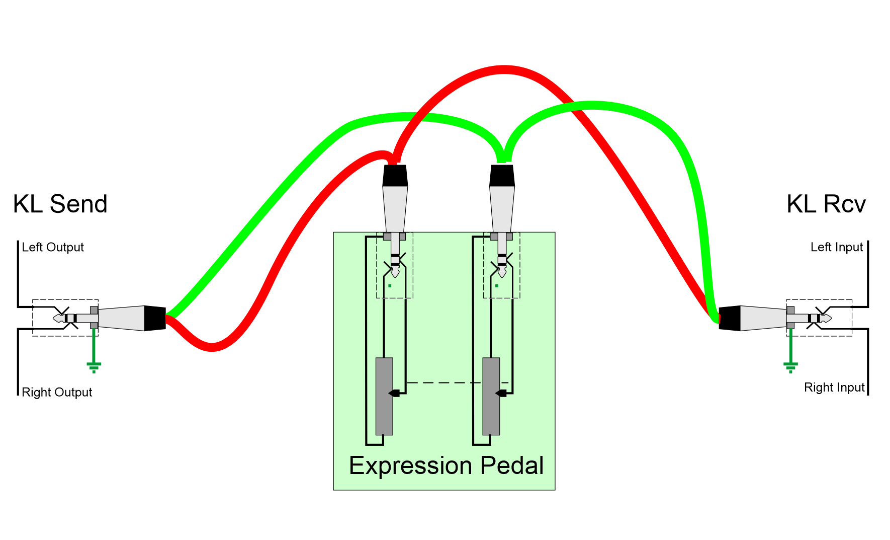

Erm... I don't think this is going to work out of the box. It's a two-channel expression pedal designed to work with control voltages. It doesn't have the separate channel input and output connections that the KL is designed for.
It could could be made to work as a volume control with the KL, but it's going to need some custom-made cabling to do the right job.
This is how a stereo volume pedal would be wired up using off-the-shelf TRS to dual TS cables: And this is how a dual expression pedal would need to be wired, using a complicated hand-made custom cable:
