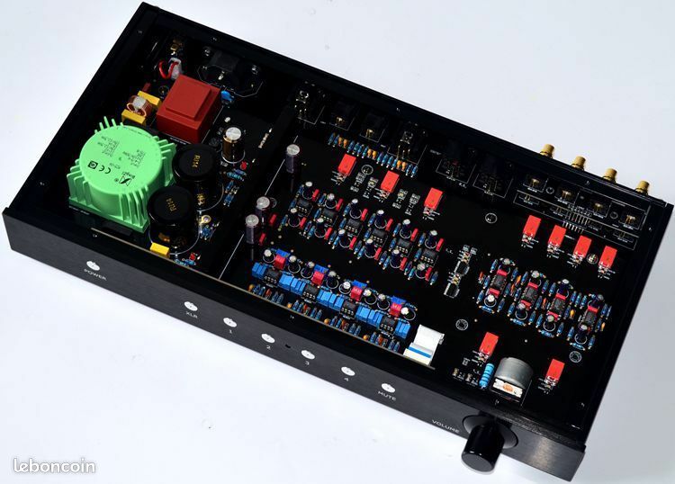

Re: The HH amps 8/12 for the Rogers 3/5
Post by CeruttiA »
I saw this preamp that a friend has created, based on the legendary MBL6010 preamp
Image download:
https://we.tl/t-Wl1JAixZf0
CeruttiA
Posts: 109 Joined: Sun Nov 29, 2015 12:00 am
Paris, France
- passionate by sound, mosty ECM Jazz
Equipment: Rogers LS 5/8 BBC version/ Audio Research SP11/ EMT 948
Post by CeruttiA »
sorry , do not know how to post images here , but I have the link.
CeruttiA
Paris, France
The image needs to be publicly visible on some host site, and its direct web address placed in the post here between img tags.
I've downloaded and inserted your preamp image in your post above for you
Post by CeruttiA »
You are most kind, Hugh. What do you think about it ?
I hear some experts say that the less electronic there is in the signal path the better, others sau that a decent preamp is much better than a passive attenuator. What do you think ?
CeruttiA
Paris, France
CeruttiA wrote: Fri Feb 11, 2022 3:46 pm You are most kind, Hugh. What do you think about it ?
I don't know anything about it I'm afraid. From a quick scan around the web it appears to be a professionally-designed line-level preamp, but I've not seen any specs.
I think the 'experts' probably aren't! :tongue:;)
It might seem self-evident that "the less electronic there is in the signal path the better", since all electronics introduce some level of noise and distortion.
However, that view is very naive and simplistic, and doesn't recognise the practical issues of real-world signal interfacing.
Moreover, entirely passive electronics can easily introduce noise and distortion too!
And in the real world, the benefits of active electronics in terms of driving cables and interfaces correctly and buffering signals with the correct input and output impedances usually far outweighs the entirely negligible noise/distortion artefacts associated with a good preamp design.
When you think of all the active circuitry involved in the recording studio console (several tens of op-amps through the signal path), the DAW and its interfaces (another handful of op-amps), and the mastering room (a shed-load more interfacing and signal processing)... do we really think a couple of (well implemented) op-amps in a domestic replay system will make or break the whole listening experience?
It's bonkers! Although obviously a cheap, nasty, rubbish active design won't sound good...
Personally, I'm in the group that argues a decent preamp is much better than a passive attenuator! Yes, I do use passive attenuators occasionally, when it is convenient or expedient to do so, but all my serious listening systems have active controllers/preamps of one form or another.
