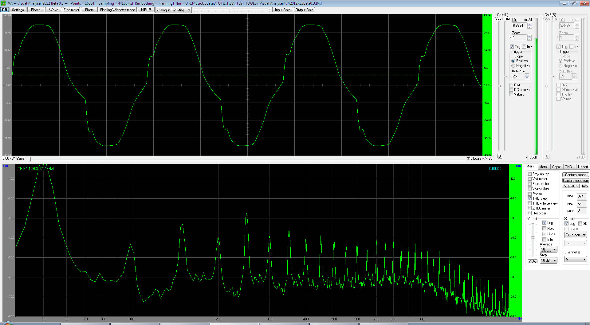

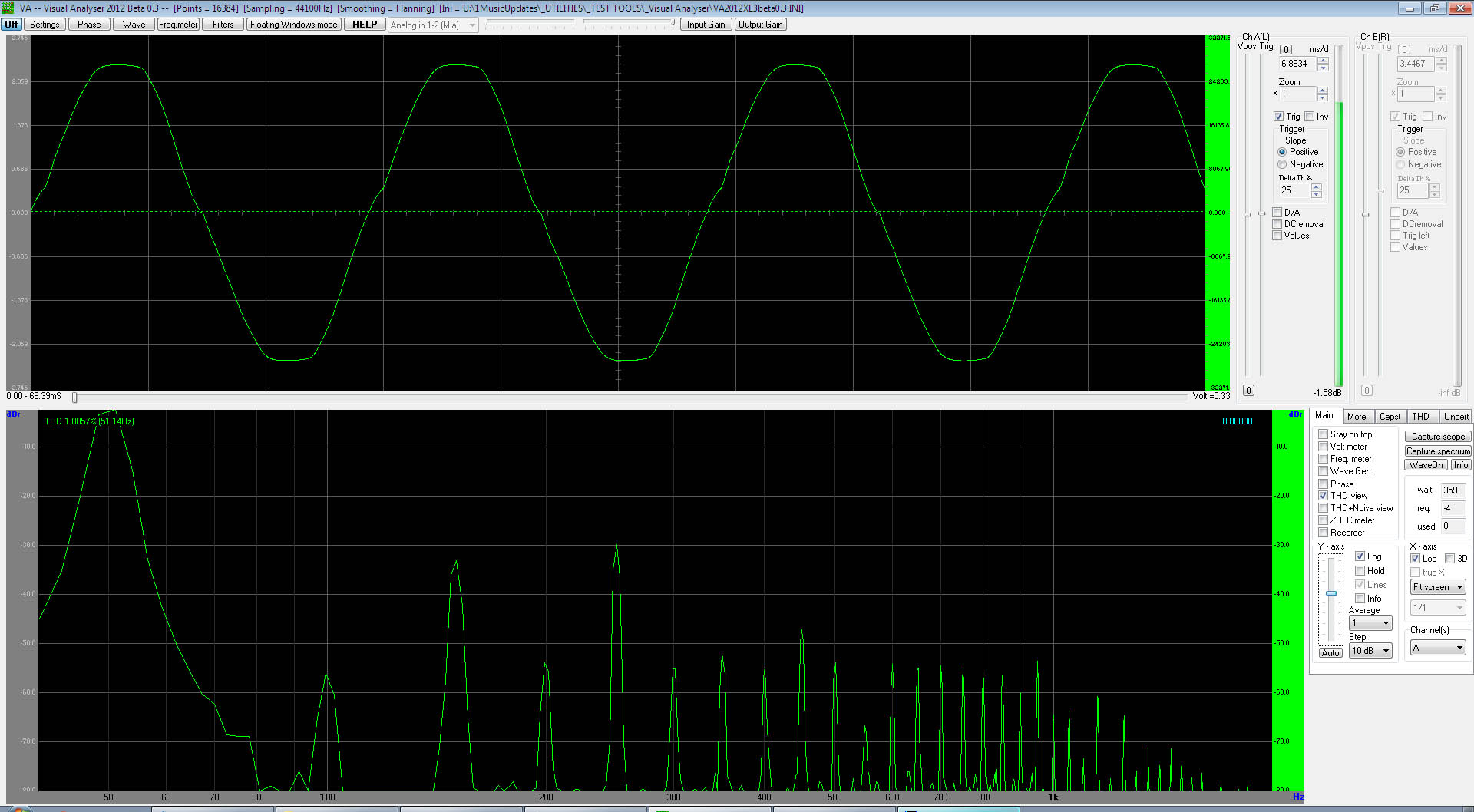

I too live in the SW in a small village, and five miles away is the Delabole Slate quarry, where there are heavy duty machines cutting and polishing the slate. I suspect this is the main reason why I notice noise on my mains supply which is worse at some times than others (it manifests as a slight acoustic buzz on my power amp transformer). The waveform below is about the worst I've monitored:
In my first job (many, many years ago) I worked in a factory where the weekly pay packets were distributed on a Thursday, so no-one worked overtime on a Thursday evening. Now it may be total coincidence, but I've regularly noticed the 'best' sound I get from my current studio is on a Thursday evening - this is the more typical waveform (not a perfect sinewave by any means, but a hell of a lot better than the previous one!)
This is what Wonks means by %THD on the mains waveform, and it's not really within a typical electrician's remit.

Mains power can certainly get 'bent' by some heavy industry nearby, as Martin's graphs clearly illustrate. But I wouldn't expect that kind of thing to cause devices to die. It shouldn't affect audio recording quality either, if equipment power supplies are well designed.
