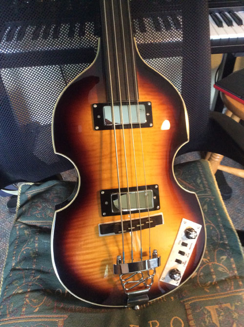

Well I said I'd report back once I'd got my Harley Benton fretless violin bass, and it was delivered yesterday.
It looks gorgeous, but was largely unplayable straight of the box, due to a convex-bowed fretboard causing serious buzzing on all lower notes. However, a quick gen up online and I was ready to do some gradual truss rod adjustment - it took four loosening 1/4 turns to do the trick in the end, getting rid of all the fret buzz by converting it to a slightly concave arc (this stuff is all new to me
I've now got some £5 feeler gauges arriving via Amazon this afternoon, to further tweak the action, but thus far I'm well pleased (apparently you need a capo on the 1st fret, your fingers pressing down on the fingerboard where it joins the body, and then a fretboard/string gap of around 0.015 inches/.381mm at the 12th fret position).
I suspect I may need help to deepen my nut slots (these require a set of special files the same width as each string, and needs doing very carefully!), but I'm not exploring that option until the truss rod is perfected, as I don't want any return of the buzzes.
I'll provide more feedback on the tone and playability once the action is fully sorted.
Oh, and Wonks, you're right about me probably needing a 1st fret marker (it's at 43.5mm, thanks to your fret position calculator), as it's a huge gap between the nut and the first 3rd fret marker! I'll see how I get on by ear first.

Well it looks lovely.
When setting up guitars I use the TRAIN acronym.
Tuning.
Relief.
Action.
Intonation.
Noodle.
Then repeat, especially the noodle part.

Re: Short-scale fretless electric bass
Tuning was easy.
Relief took some on-line effort before I felt confident enough to gently adjust the truss rod in small stages.
Action - this is the tricky one, as fretless instruments need slightly different string heights from the fretboard, and I've got a set-in neck, so the bridge height could also prove critical to a low action.
Intonation sounded good straight out of the box, although I've already had advice to replace the current tape under the bridge with double-sided sticky tape once I'm happy with the bridge position, to make sure it stays there
Noodling is probably the easiest part
I see you’ve already mentioned the under-saddle plastic removal.
You may need to re-intonate it after loosening the strings enough to slip the material out, but you could wait to do that after sorting the neck relief out and adjusting the action.
You can also ‘pin’ the bridge in place, which I’d prefer to using double sided tape as a permanent measure, but don’t do that until you are fully happy with the intonation and your string choice.
The amount of neck relief you need depends on how straight/level the fretboard itself is, as well as your preferred action height. You won’t have the problem of uneven fret heights affecting playability, so you may get away with having slightly less neck relief than on a fretted bass. But I’ve never set up a fretless bass, so gave no idea if a really low action (and so a small string to fretboard angle) has an adverse affect on the sound.
Thanks for the expert advice Wonks!
Yes, I'm still unsure about whether or not to do deeper nut slots (low E currently sits about 2mm above the fretboard at the nut).
Part of me thinks that once I have the truss rod adjusted so that I can play without any buzzes with a capo at the first fret position, then I could (theoretically) file down the nut slots so that the strings are just a tiny amount above the fretboard, or even flush with it, as the only difference would be when playing open strings.
On the other hand, I'm also starting to read about setups to achieve the best fretless 'mwah/growl' sound, so I'll imbibe that advice before deciding on the final action.
The nut needs to be a little higher than the fretboard or you may get buzzing behind the fretting finger as the string will be more or less resting on the fretboard between the nut and your finger. Nut slots (and zero frets) on fretted instruments are typically cut a little higher than the first fret to prevent this.
I don't have any feeler guages to hand but looking at my upright I'd estimate the gap from the bottom of the string to the fingerboard to be about 1/3mm.
Give or take.
Since there aren't any frets, the lines are only there to get you to roughly the right place and the whole joy of fretless is that gives access to all those in between notes (as well as removing the tuning compromises caused by frets in the first place), setting the intonation really doesn't matter.
On a bass like yours I'd get the angle of the bridge so that E and G are roughly in the right place and leave it at that.
Remember also that on the higher "frets" the dots are going to be subject to parallax.

It's not a good idea to leave the fret slots unfilled. For a start you'll start to wear the edges of the slots where you are pushing the string down on them a lot quicker than the rest of the fingerboard.
But the fingerboard, as part of the neck, is under compression from the strings. Leaving the slots empty prevents a lot of the fretboard from being part of the compressed neck area and so helping to spread the load. As a result, the load-bearing cross section of the neck becomes smaller and puts more strain on the rest of the neck, making it far more likely to develop a bigger bow in it over time and possibly to twist over time as well. Even a softwood fillet, if glued in well, can add strength back in to the fretboard under compression.
Extra bow can normally be compensated for by the truss rod, but the truss rod is then also pressing harder against the fretboard. Leaving the slots unfilled makes areas of the fretboard weaker and there is always the chance of the fretboard cracking along a slot line.
If the rest of the neck is of strong construction (especially if a multi-laminate), then you may never see any ill-effects, but it really is much better to fill the slots than leave them unfilled.
Edit: As Big Red X says, it is a good idea to go over the fretboard with a suitable radius block after defretting and then filling the slots. It's surprising how uneven some fretboards are.
I suspect that might explain why my D string needed the truss rod slackening off a little more, to avoid the string buzzing at the 3rd fret position and below, while the other three strings were already totally buzz-free.
Posts: 22527 Joined: Wed Jan 13, 2010 8:44 am
It may also have been that the bridge radius doesn't quite match that of the fretboard. In theory it should be very slightly larger radius.
Had you had a bridge with individual saddles with string height adjustment, you may have just needed to raise the D-string saddle a touch.
Or it could be a mixture of both.
