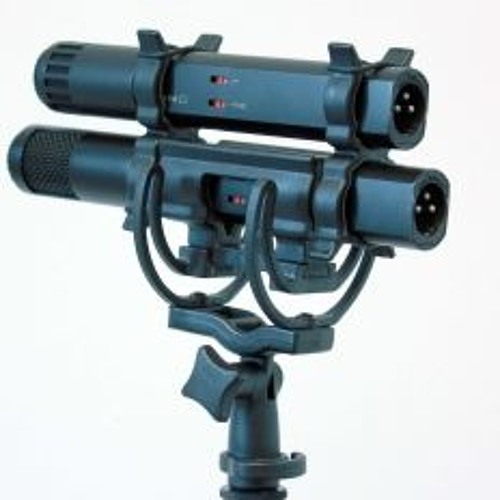

one configuration that I come back to often for small ensembles is a pair of parallel-mounted (one above the other) Sennheiser MKH30/30 (fig-8 Mid)
??? Is this pair at 90%, not parallel?
Re: Recording Sax orchestra live
I don’t think parallel is the correct term here. Vertically stacked in-line, diaphragm end to diaphragm end, with the mid pointed at the noisy stuff and the fig-8 sides rotated 90°.
The mkh30 is a side-address fig-8 (incorrectly mounted at the bottom in this Google pic), while the 40 and 50 are end-fire conventional pencil mics (on the top in this rig image).
Consequently, MS arrays using 30/40 or 30/50 combinations are mounted parallel, as shown above, one mic above the other.
For a Blumlein MS array using a 30/30 combination, you can use the same basic hardware, but arranged to be vertical with the fig-8 Mid mic at the front facing front-back, and the Side mic behind it facing left right, but slipped down a bit to avoid shadowing the rear of the Mid mic.
The two mics are still parallel in this arrangement.
Thanks, that makes sense, I couldn't visualise it, but having them vertical and one effectively at 90 degrees to the other is what I was getting at.
