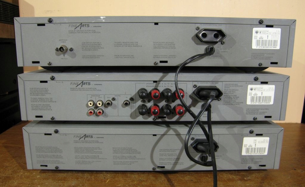

Mike Stranks wrote: Mon Feb 06, 2023 7:20 am
punkyfish wrote: Fri Feb 03, 2023 7:39 pm Struggling to find a CD player
(A word of caution on the mini-systems. Some of the ones I've seen that appear to be 'separates' use proprietary 'all in one' - mains and signal- interconnects between the units, so not easily used in standalone mode.)
Slightly off topic but came across something on the vintage radio forums, turns out that Grundig did a separates system that is even more proprietary than possibly anything else, the CD player, for example, only has a mains in and out, the tuner adds an aerial socket and the amp has just one digital and one analogue input that are not used by the related components.
A look at the front of the units and the model numbers AS-IR for the amp and CD-IR for the CD player might give you a clue as to how the unit's were interconnected, and yes it was a mad method!
https://a.allegroimg.com/s1024/0c4b38/7 ... f08ec33af2
https://www.fein-hifi.de/images/product ... 0b8de9baff
As for buying a CD player I got the correct one for my Technics integrated system for around a tenner a couple of years ago.
Edited to fix quotes - JP
