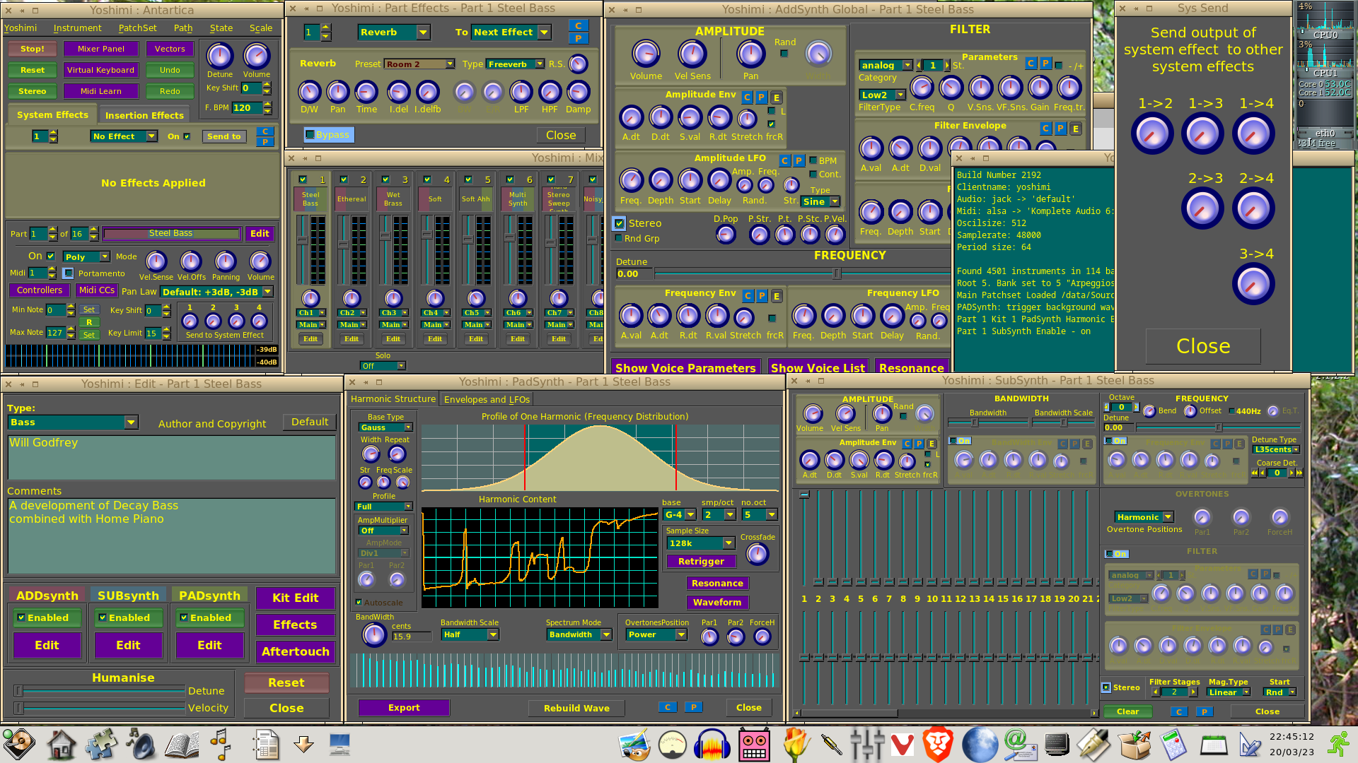

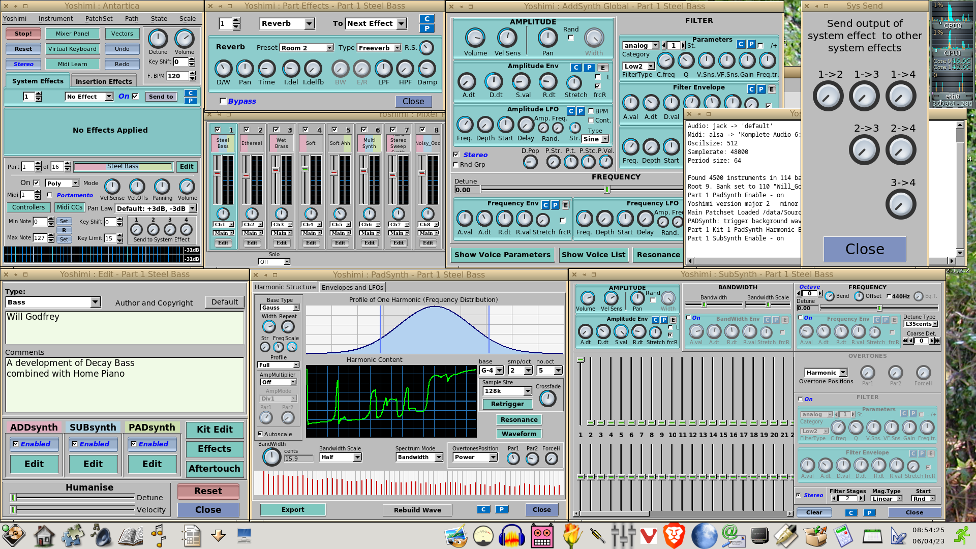

Here's a look at the latest version of the 'classic' theme:
http://www.musically.me.uk/Photos/Yoshimi-native.png
If you look closely at the sliders, you'll see they now have coloured centres to the 'pegs', and in the Mixer window some are red while all the rest are green. Red indicates being off the default value and I'm currently working though the knobs doing the same for their pointers.
I've had a complaint (from just one person) that the link buttons no longer look like buttons. Does anyone else have an opinion on that? Nothing is (yet) fixed so I really want to get this 'comfortable' to as many people as possible.
Posts: 20899 Joined: Sat Nov 15, 2008 12:00 am Location: The Mudway Towns, UK
Re: Yoshimi - Buttons!
Folderol wrote: Thu Apr 06, 2023 10:56 am I've had a complaint (from just one person) that the link buttons no longer look like buttons. Does anyone else have an opinion on that? Nothing is (yet) fixed so I really want to get this 'comfortable' to as many people as possible.
I can sort of see what they mean on some of them, for example the Aftertouch button (and the others of that format). The shadowing on the border doesn't imply a raised surface to press. Unlike, say, the Reset or Close buttons beneath it.

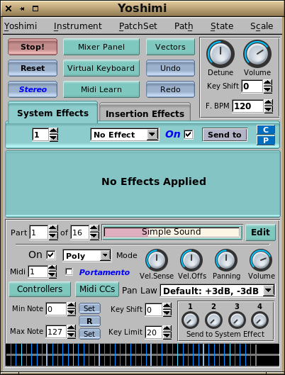

Hmmm.
OK, here are a couple of alternatives in the main window, (which has the greatest combination of action and link buttons).
http://www.musically.me.uk/Photos/Main_alt1.png
http://www.musically.me.uk/Photos/Main_alt2.png
alt1 is more distinctive, but alt2 might keep people happy and still (just about) seems to work without colour, or with 'weak' theme colours.
Option 2 is more consistent and I would suggest more obviously a button.
Posts: 29732 Joined: Sun Jul 05, 2015 12:00 am Location: York
Post by BJG145 »
Definitely 2.
I'm wondering why I think that, and it may be partly because the top ones are all grouped and similar except for being a mix of raised and flat designs. At a glance it looks like the first three are ready to be pressed, and the last two, and maybe the ones in the middle have been pressed.
I think maybe the flat design could work in a separate group, but I find the mix distracting in this instance. I don't mind the two separate ones at the bottom so much; in fact I think I prefer that.
