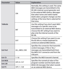

According to page 21 of the manual:
1) Press [EXT CTRL SETTING] button
2) Use Scene category buttons [0], [1], and [2] to select the zone whose settings you want to edit
3) Use the cursor buttons to select the TxMode parameter and use the [DEC] [INC] buttons to set the value to ON

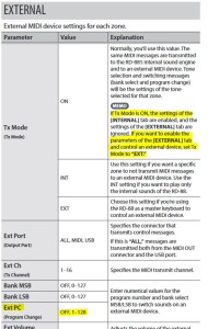

Note also the settings in Zone Edit mode as detailed on pages 4 and 5 of the Parameter Guide:
1) Press [MENU]
2) Use the cursor buttons to select “SCENE EDIT,” and press the [ENTER] button
3) Use the cursor buttons to select the item that you want to edit, and press the [ENTER] button
Essentially it would appear that to transmit Program Change you need to set the Tx Mode of a zone to EXT and then enable the Ext PC setting for that zone.
As I don't own an RD-88 I can't really say more than that but the info in the manual looks like it should be enough to navigate through with a bit of experimentation!
