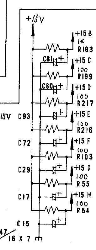

If it works OK with batteries, then it can't be a real problem with the TR606 and I'd imagine is down to not getting enough voltage due to the difference in PSUs.
The internal circuitry dealing with the PSU input is in the middle at the top of the circuitry of page 5 of the service manual (input shown at grid position B17).
https://www.synthxl.com/wp-content/uplo ... -notes.pdf
I don't know enough to interpret it, but someone might be able to say whether you're likely to get the full +6v,+15v and +5v with just a 9v DC input. Comments elsewhere on the ACA adaptor indicate that you're likely to get nearer 6v internally than 9v on a lot of Boss pedals.
The current draw of the TR 606 is between 70mA and 150mA depending on how many instruments are outputting at once and the volume setting.

Re: Roland TR-606 hum when LEDs are on ...
i finaly figured out by removing the coupling caps before the headphone and line stage that the noise is injected by the 15V lines on this last stages.
i found that there is a dispatcher of the 15V lines to the diferent parts of the circuirt.
this way i can turn off progresively all the 15V parts of the circuits , and somehow isolate the zone with the issue.
also , when i touch or move around C81 , the noise is reduced quite a lot.
i replaced this capacitor , without any improvement.
any ideas.?
any ideas.?
