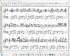

Hoping there are some Cubase 8.5 Pro score experts here.
Below is a screenshot of a piece I am sequencing, and have become fairly competent with my musical "knowledge" normaly, but for this task, the piece has got me stuck.
Problem is the inputting of and making the notes play/work with the number"2" above the pairs of 32 notes, IE "play the two notes in the time to play three"
Help.
Only works by using link direct, as cannot get image to post.
https://app.box.com/s/akqrce4iat1mz8mqskrjz857ozhaxe4d

Seems the image wont show and cant delet post to try again......
Works by using link direct

I've inserted the image for you. You're right – that host doesn't play nice with links...

pa28 wrote: Thu Mar 30, 2023 1:46 pm Problem is the inputting of and making the notes play/work with the number"2" above the pairs of 32 notes, IE "play the two notes in the time to play three"
Not a Cubase user, but I don't see two in the time of three. I'd read that as phrasing hints. So those last two notes in meas. 79 should not sound like the ending of the preceding notes, but instead should lead in to the start of meas. 80. From a sequencing point of view, I might try starting each of those "2" phrases slightly late, and/or ending the preceding note slightly early.

Bar 79 adds up to 16 16th notes without two notes in the time of three. The two is wrong here. I would think on using two notes in the time of three in a time signature like 6/8, which has triplets as the underlying rhythm.

Exactly! When I first read the post and went to look at the pic, I was expecting 6/8, and was surprised to see the half-measure beamed eighths that add up to 4/4. Additionally, it looks like beaming in general has been chosen to represent phrasing instead of rhythm, making it very hard to read.
