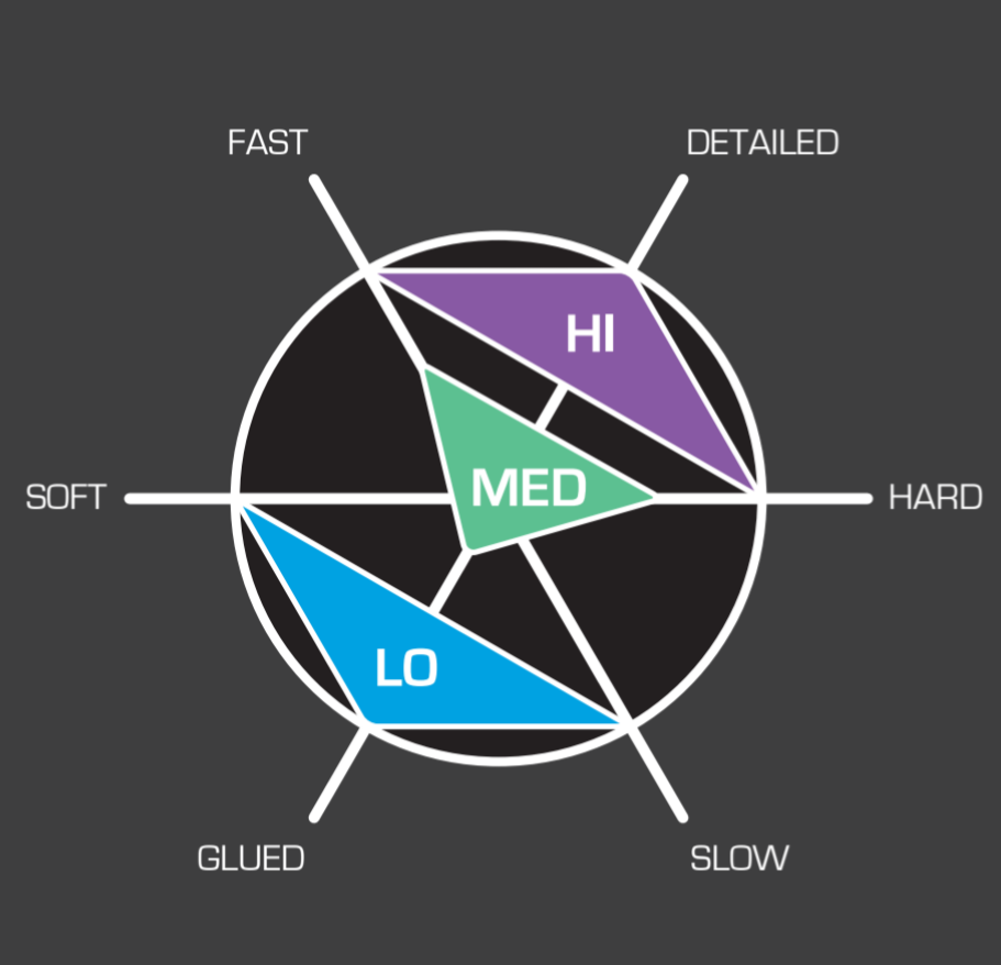

James Perrett wrote: ↑Sat Jul 08, 2023 1:05 pmThe same goes for my Audient preamp with switchable impedance. I tend to keep it on 5k...
But it has reminded me that the user manual for the 880 included an interesting chart suggesting sonic differences for different input impedances for moving coil mics with transformer outputs (like the SM7B, SM57, M201, D224e etc)
Lo = 220 Ohms, Med = 1200 Ohms, Hi = 2800 Ohms.

Re: Mic impedence tricks and tips
Now that's interesting.
Did you mean that your setting has never moved from the Middle 1200 position, or High 2.8k position?
Have you enjoyed the blissful benefits that this chart promises -- or is this Audient running with an idea to have some fun?
- chanceoperation
Poster - Posts: 61 Joined: Fri Aug 01, 2008 12:00 am Location: Montreal
chanceoperation wrote: ↑Sat Jul 08, 2023 4:21 pmDid you mean that your setting has never moved from the Middle 1200 position, or High 2.8k position?
I've tweaked my post to make it clear — the switch middle position is the higher impedance setting (which the manual says is 2k8 and my review said was 3k6!)
I think the chart's claims of sound characteristics are broadly true for most moving-coil mics, in my experience. The relevant impedance values aren't tgat critical but depend on the specific mic's own frequency-dependent impedance curve.
As a rule of thumb, low would count for anything around 100-300 Ohms-ish. Medium would be 1-2k-ish, and high above 3k Ohms... in broad numbers.
