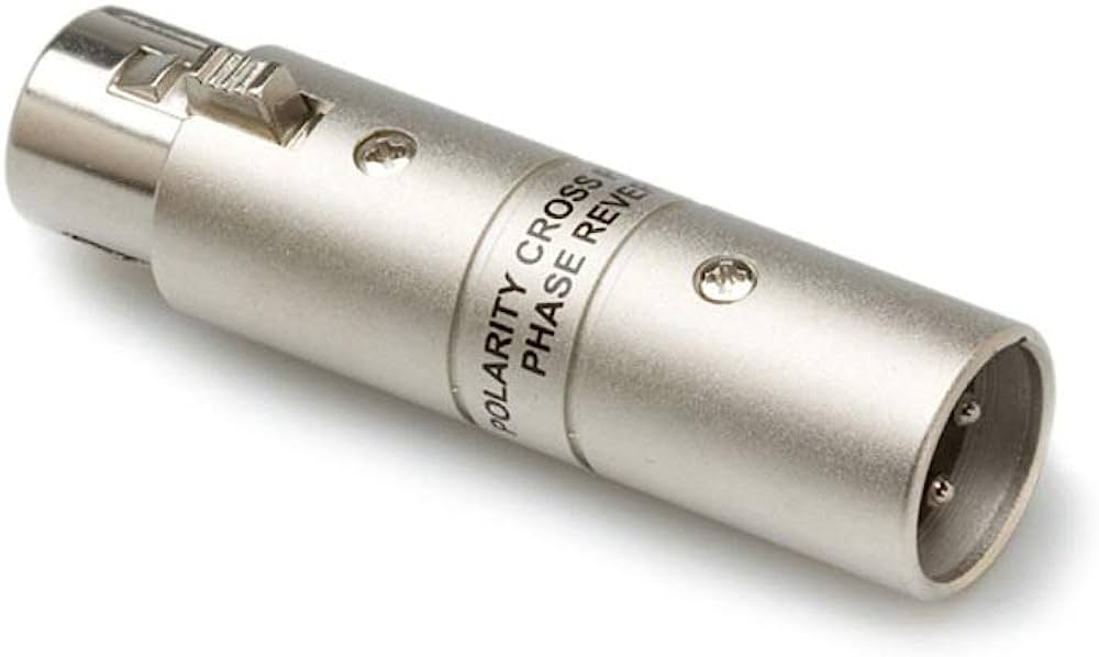

On the subject of Focusrite, is it possible to reverse polarity on that unit?
Not that I can see. I imagine they expect that to be done in the DAW.
I have a mic that needs polarity reversal, so I have to figure out a way to do this.
Invest in an XLR barrel (inline) polarity (phase) reverser! I think Shure, whirlwind and others make them (Make sure pin1 is connected st both ends — some 'line level' ones don't!)
Best value is probably the Hosa GXX-195. Costs around £10. The blurb says its for line level signals, but it's fine for mic signals too, and pin-1 is connected.
Amazon UK here
Or if you can solder, make up your own dedicated polarity reverse cable. You just need to swap the signal wires on pins 2/3 at one end! ... and label it clearly so it doesn't get used where it's not needed!

Thanks for that quick and thorough reply. Seems I'll be going analogue then. Didn't quite understand what you meant with the ADAT in - there is an optical out from the UA preamp, and an optical in on the Clarett, but seems like latency-free monitoring is out anyway when using that, so I'll just go with the analogue inputs. Great tip about the inline thingie - didn't know they existed! Thanks again.
