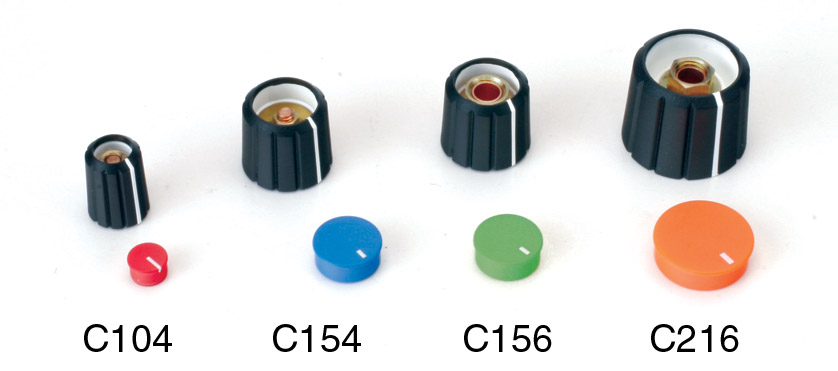

Some knobs are tightened onto the shaft with a collet hidden under a plastic cap, you pop the cap off and it exposes a nut you have to loosen to remove the knob. This sort you definitely can't just pull off.
However if the knob looks like a single piece without a removable cap, and it doesn't have a grub screw, then, yes, it's probably the prize-off type.
