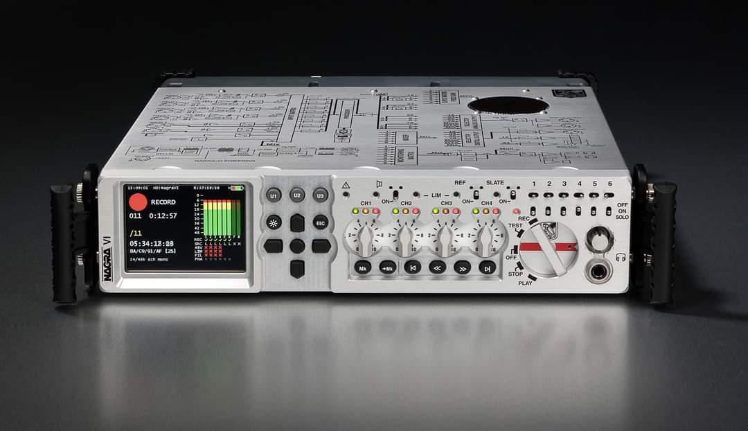

I bought an F8nPro recently as a backup machine for a Nagra VI (which is my primary location recorder) and I'm very impressed with its versatility and convenience, plus its superb value for money.
If I was being picky, the machine's ergonomics and preamps aren't as good as those in the Nagra (although that only provides 4 mic inputs). But it's a tenth the price and a quarter the size!
Regarding the Sound Devices suggestion, the Kashmir preamps are also a tad better than the Zoom's and you get 8 in the MixPre10 mkii.... it's a versatile machine and well designed... but more expensive than the Zoom. Also, you'll need to budget for external battery packs of some kind for the Zoom/MixPre.
Both machines offer a 32bit-float record option for those situations where you can't manually set record levels. I've recorded a couple of events now with the recorder placed at the base of a mic stand supporting a stereo array (or tree), and just let it get on with it. No cables across the floor, fast placement, no concerns over setting levels. Not my ideal method of recording, but very pragmatic.
If you're looking to keep costs down and you're not using top end Schoeps, Sennheiser MKH, and Neumamn mics, the Zoom F8n pro is a very attractive option... and even if you are using high end mics the F8s preamps are still pretty darn good (better than most interfaces) and will rarely if ever be the weakest link in the chain. (And with enough gain to make those M201s viable!).

Mine is the special edition with the milled faceplate and proper Nagra pointy knobs (rather than the standard plastic edition)... so it actually looks like a Nagra!
It's a bulky machine by modern standards, but I prefer having some space between the controls, and a display I can read without glasses.
It has four stunningly good mic preamps, plus two line inputs which double as AES3 inputs.
So I can run four mics just with the Nagra, plus two line inputs (from a keyboard or other line source etc), or six mics with an external stereo preamp (I use a battery-powered SoundDevices MP-2) or eight mics with a digital preamp (I use a Focusrite ISA428).
I bought mine pre-loved, so not as cripplingly expensive as the list price, but it is a thing of genuine beauty, aesthetically, engineering-wise, ergonomically, and sound-wise. And undoubtedly the best sounding recorder Nagra ever made, building on the basis of the Nagra-D.
