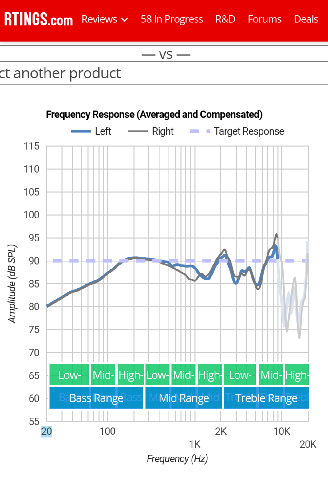

James may have hit the nail on the head by saying it’s in their interest to emphasise anomalies but who knows, as the response curves from headphones seem very variable dependant on the testing methodology.
As an example take a look at this website which compares the two side by side: https://www.rtings.com/headphones/tools ... shold=0.10
Anyway I have the DT900s. Not as accurate as HD650s but still very good and importantly, I find them very comfortable. Haven’t tried the 712s.

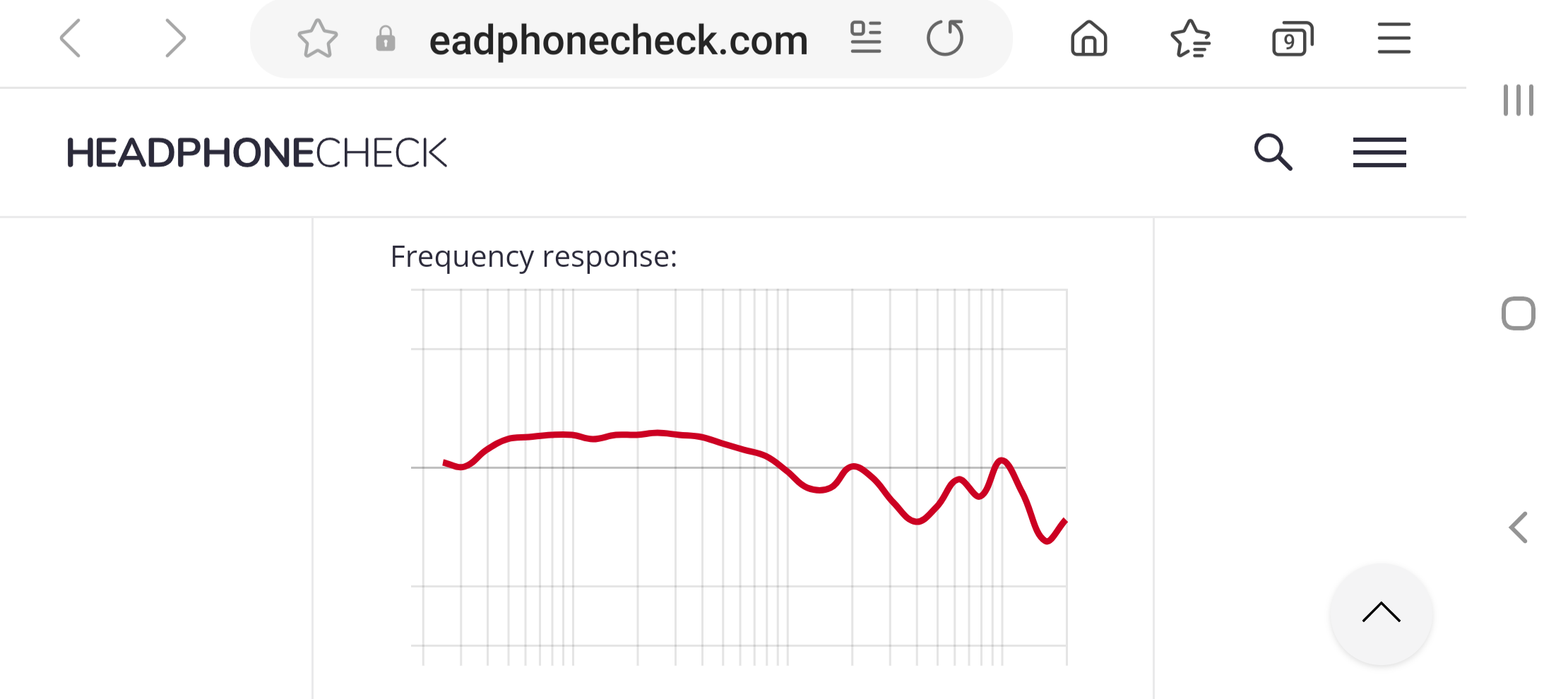

Small differences in the measurement technique can make big differences to the published frequency responses.
These are all AKG K712 Pro published review measurements.
They all show a bit af bloom around 300-400Hz, but thats the only similarity. The LF roll-off varies enormously between plots, as do the centre frequencies and amplitude amounts of the HF peaks/dips.
Most headphone plots show lots of obvious peaks/dips at HF due to strong reflections and phase cancellations within the measurement rig. Slight positional differences consequently give massive differences.
I'd take them all with s large pinch of salt, and rely on your own ears for judgement instead!

Hugh Robjohns wrote: ↑Fri Sep 29, 2023 9:42 pm Small differences in the measurement technique can make big differences to the published frequency responses.
Wow... This may be the end of frequency response graphs for me
There should be stores, letting us take our time, listen to the headphones we want and analyze them as much as we want. Unfortunately, there's not many of them.
